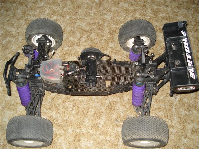

Hey guy's,

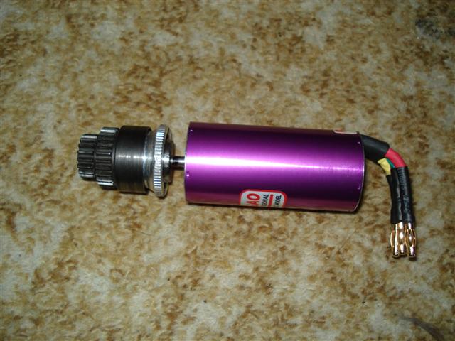

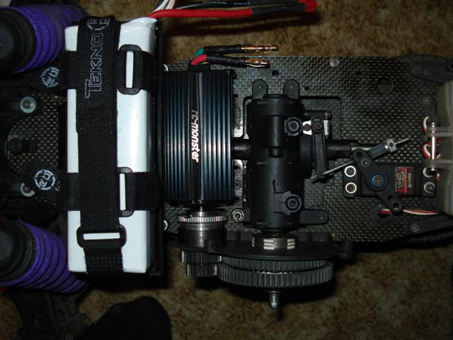

I finally got some pics of my BLST (Brushless Losi Super Truck, for the uninitiated.) & still have to wait for my ESC Quark SSB & gotta get off my arse & get this motor mount made up.
Got the battery tray in, the heatsink & clutch adapter for the motor.
I have pics, just hope they turned out.

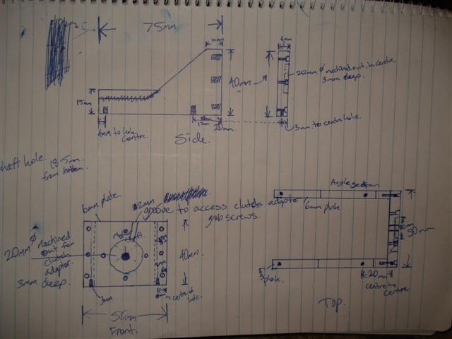

Name:	This is my mount design, but, I think it's wrong somewhere in the measurements.JPG

04.21.2008, 02:00 PM
So are you still using the clutch or are the shoes locked?
What are you doing for a motor mount?

You mustn't be wearing your glasses today.

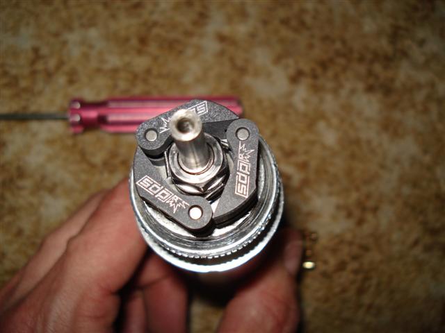

Read what I wrote & look at the pics. I have included the design for my mount & you can see that I have the entire clutchbell & clutch assembly attached to the Feigao in the 3rd pic.
Also, if you look at the 2nd pic in the first post you will see that the clutch shoes are intact & so are the springs. This set up will save the motor from sudden stops from 50,000 RPM as I have NO intention of loosening the slipper.
The mount is a custom design by me & needs to be machined. I have the aluminium here, just lazy.

04.21.2008, 03:14 PM
looks good dude.. but aren't you worried that the clutch bell is so far from the shaft.. it could be putting a lot of strain on the 5mm Feigao shaft & bearing.. other than that, it looks awesome... !

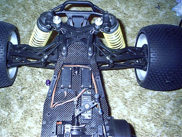

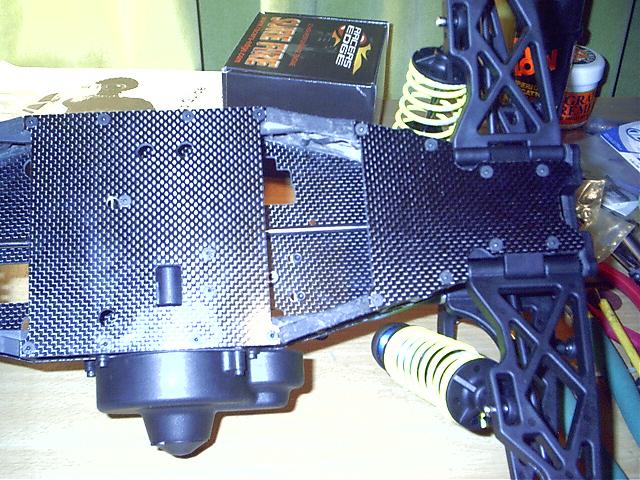

04.22.2008, 10:11 AM
The motor mount will fill that space between the clutchbell & faceplate.The clutch adapter covers 10mm of the shaft. Seeing that you just mentioned about the support, I might press fit a bearing into the frontplate of the mount.

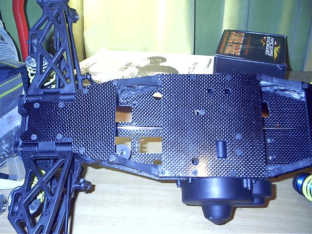

The whole truck is carbon, from the top plates under the shock towers to the plate behind the bulkheads & also the skid plates underneath.
I've got alot of pics of it.
I actually saw Holeshot Engineering's design & asked if it could be modded & he agreed. So, I sent him my design & he made it for me. He also sold alot of them too.
It's not much lighter than the original alloy, but, it is much more rigid.
The truck should weigh in at approx 5.3kg, sorry, I only know metric. The original LST 2 is a porky 5.8kg. So, I guess half a kg weightloss is better than a kick in the arse.

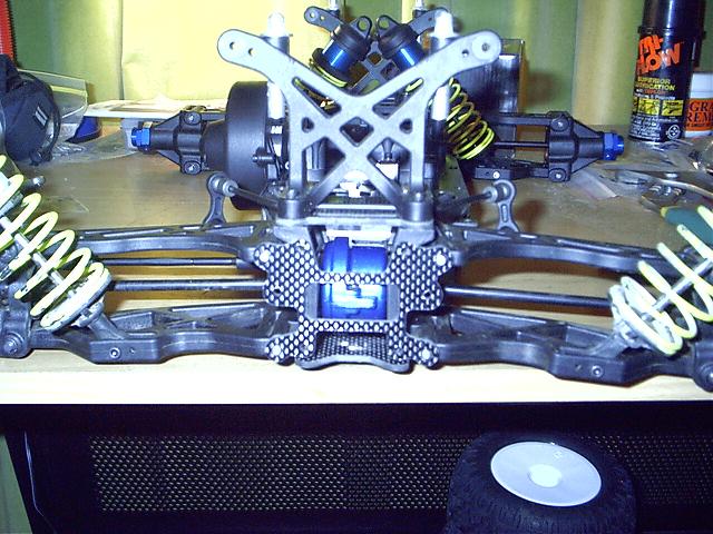

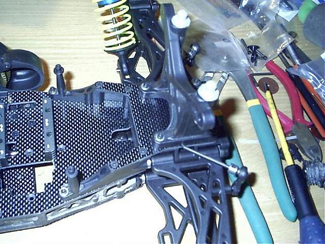

The attached pics are of my LST when it was being built as a nitro.

I've got a serious medical condition & have been a bit busy to get to the engineering place that's going to machine it for me.
There is a pic of my design.
It's more suited to a Feigao motor & the clutch adapter is a custom job too. Check out the Revo conversion from Tekno & you'll see their clutch adapter. Mine's virtually identical except with a few changes here & there.
