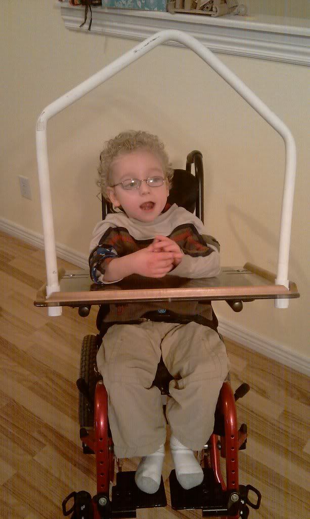

I'm modifying my son's wheelchair tray to accommodate a toy hanging arch I'm making out of PVC. It's not elaborate by any means, but I think he will love it.
I just cut the PVC, and I'll be bending it into an arch for the toys to hang from. This too is something I haven't done before, but it looks simple enough. Fill tight with sand, capping each end, hit it with the heat gun, then bend and cool. I'll be sure to post pictures when I'm done.

It's rough, but it's a first draft and will make him happy. Now I will just need to drill holes to hang toys from. I like it because it's removable for when he's not using it. I'll do a nicer second draft and get it painted up to match his cool red wheelchair.
Any thoughts on how I could improve it? I'm open to all suggestions!
Thanks again!
He sure has grown since he got this wheelchair three years ago:

That chair looks pretty cool. Very modern up to date design. I like your approach of making up some removable items for his entertainment. They deserve whatever we can do to make their lives more tollerable. I would say a 9" DVD player that can hang up in front of him, that he can control and watch whatever he wants. Anything that gives them some sense of personal control is a boost for their self esteem, and confidence. Good move.

Nice work Dad! Here's a couple thing I would want on mine at that age. Beer holder. JK How about a fisher price steering wheel. To pretend I was steering it while we are out walking. Maybe a make shift review mirror so he can see you smiling all the time. I see those steering wheel they make for nintendo, sega, etc games at the thrift shop all the time for a buck or two. They usually have a setup to allow it to clamp the the table.
How about drilling a hole opposite of each other running a line across the brace. Then using a small quick hooks to hang the toys from the line. Could put one up above and one below. Then you could clip the toys to the line on the bottom one also (depending on the toy of the day) so they don't get knocked off the table. With the line and hook setup you could go overboard on the number of toys you have hooked on there vs drilling a hole for each line.
Maybe make a matt/picture to sit on the table that resembles a race track. Then hook up some hot wheel cars so he can race around the track. Hook a small line to the car because we know that he might not make every corner and that car would be on the floor more them on the table. The line will hopefully keep it in play and save you on bending over and getting it off the floor.
I got some of the clamps at K-Mart for .99 and Harbor Frieght had them for .49 a couple weeks ago. They look like the kind of hook a climber would use but not much bigger then a quarter in size.
