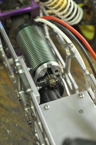

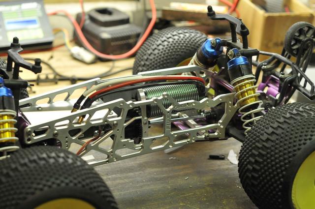

After years of working on this truck I'm finally happy with the set-up and I'm considering it DONE. I have rebuilt most of the truck at least 3 times.
Phase 1:
Chassis: Carbon fiber
Tranny: Kershaw Gen II
Motor: CC 1518
Arms: Aluminum
Shocks: HPI
Axles: HPI
Hubs: 17mm
Phase 2:
Chassis: FLM Aluminum
Motor: CC1717
Arms: Aluminum
Shocks: HPI
Axles: HPI
Hubs: 17mm
Phase 3:
Tranny: LOSI Center Diff
Motor: CC1520
Arms: RPM
Shocks: LOSI
Axles: LOSI
Hubs: 17mm
Final Phase:
Tranny: D8T Center Diff
Motor: CC1520
Arms: RPM
Shocks: LOSI
Axles: LOSI
Hubs: 19mm
Extras- Losi Muggy wheels, Aluminum 1 piece rear hubs, aluminum radio tray.

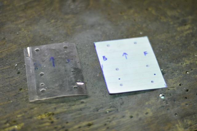

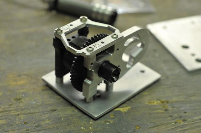

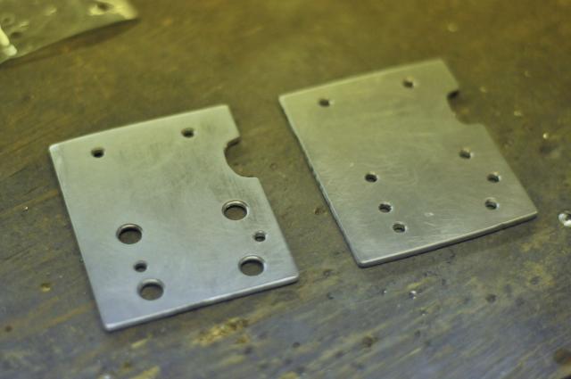

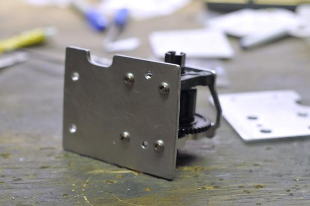

Here are some pics from the final machining last weekend.
Name:	final sav plate 1.jpg
ID:	10711   Click image for larger version
Name:	final sav plate 2.jpg
ID:	10712   Click image for larger version
Name:	final sav 1.jpg
Name:	final sav 2.jpg

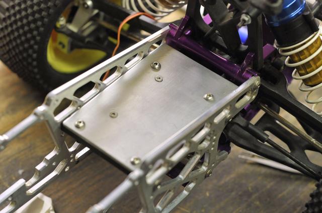

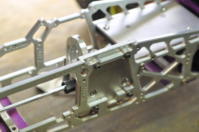

More pics:
Name:	final sav 3.jpg
ID:	10715   Click image for larger version
Name:	final sav 4.jpg
ID:	10716   Click image for larger version
Name:	final sav 5.jpg
Name:	final sav 6.jpg

That's a great build!!! I love how low the motor is in the chassis, it should handle well.

01.26.2014, 07:08 AM

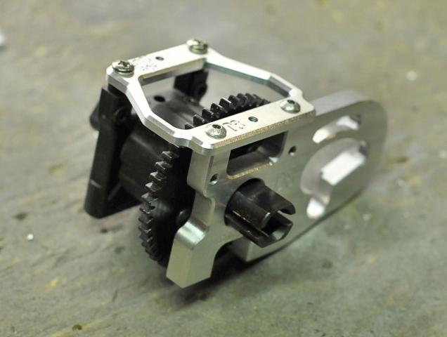

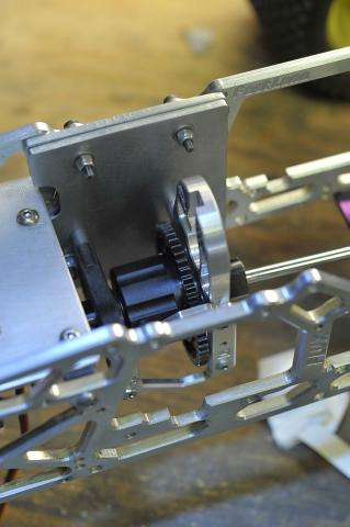

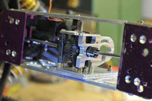

Great build! What diff mount is that you have used?
01.28.2014, 08:20 AM
That's the RC monster universal center diff.
RC-Monster Mike
Site Owner
RC-Monster Mike's Avatar
Posts: 4,915
Join Date: Nov 2004
Location: PA
01.31.2014, 09:27 PM
It is actually an RC-Monster D8 motor mount and top plate mounted at 90 degrees. :)
02.01.2014, 09:49 AM
Oops I didn't even look at photo's - I just saw motor mounted over the diff - my bad
RC-NUT
RC-NUT's Avatar
Posts: 121
Join Date: Oct 2006
Location: SANDOWN, NH
02.03.2014, 11:16 PM
Mike is correct^^
I took a different approach by mounting it in sideways. But in the end the motor is centered in the TVP's and it doesn't sit too high. I ran it this way for the last 2 summers without issue. (With Muggy parts)
It handles pretty well. The tires tend to roll around corners which is pretty funny to watch but it doesn't flip over.
On 6s it's a little nutty but on 4s it's fun. I will have to get some videos when the warmer weather arrives. Due for 8-10" of snow tomorrow.
