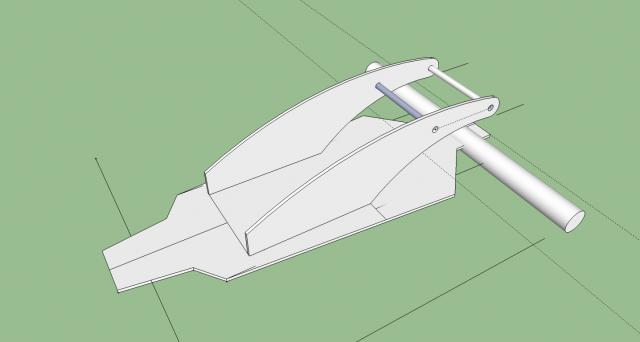

hey guys, been wanting to start this for a long time. so here we go.
Twin force rear axle with MP 7.5 diff narrowed to 12.5"
chassis will be custom cut to length.
vertical plate will be cut from 4mm black or 4.5mm red CF
take a look at the google sketch-up for my ideas so far. took me a better part of an hour to get this going.
for those of you who use sketch up i can send you the file just send me a pm.
will have either tekin 1/8th or MMM system.
trick will be mounting the batts.
real pics coming when i find my darn memory card...

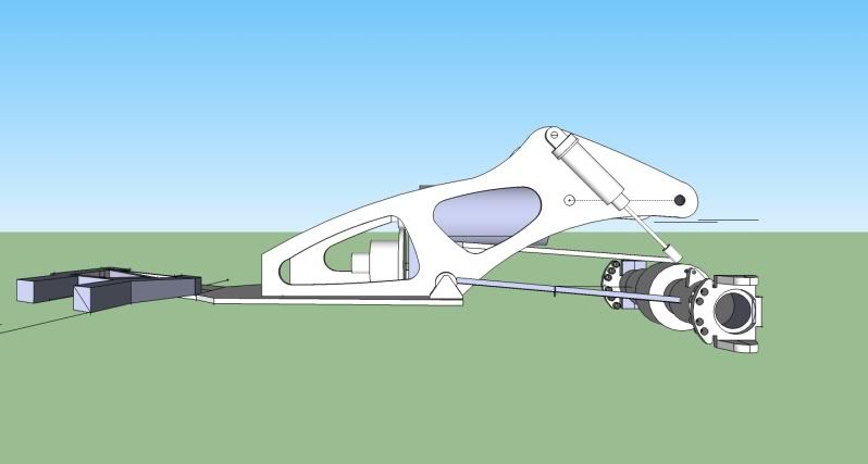

here are couple more shots with some more work done...
i think this will be the best place for the motor, as i dont really see a good way to mount it lower on the chassis yet.

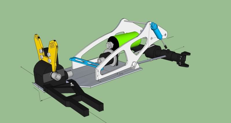

some more design pics.

its a little more shiny now :)

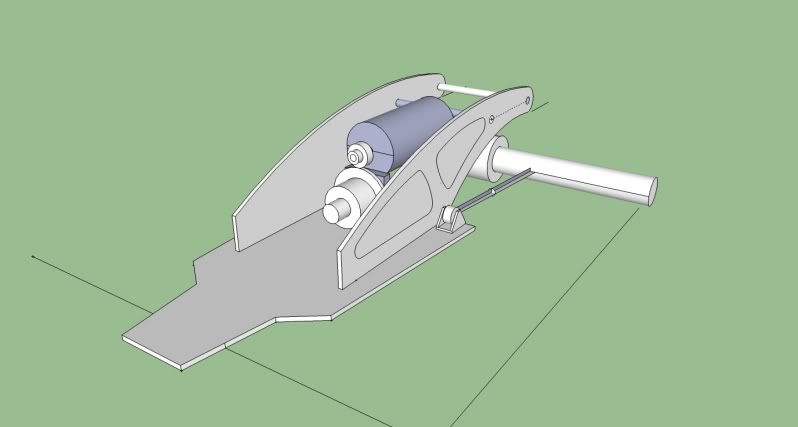

so figured out the pacing a little. reverse the chassis will give me plenty of room up-front.

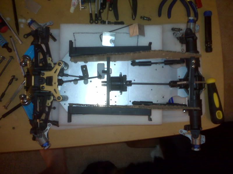

here's my update... (sorry bout the pic quality)
well here are some updated pics.
took some 3mm carbon and made some pieces for the lower link mounts. also got the knuckles locked. they will look cleaner when its ready to drive, its all text fit for now.
i plan to use some kyosho ST upper rear arms for the links. they are quite a bit longer, and pretty much beef.
also got an idea for the shock mounts on the turnbuckle part of the lower links. i will have to get that up here in the next few days as well.
still workin on the sides of this thing. i have the carbon. and been thinkin about just getting a rotozip to make my own. i have had a few suggestions from people who could cut it for me, but i am affraid of getting the measurements a bit off i guess.
anyway: onto the pics. (with my blackberry) i know im lame

here are some better pics, got the memory card issue sorted out.
