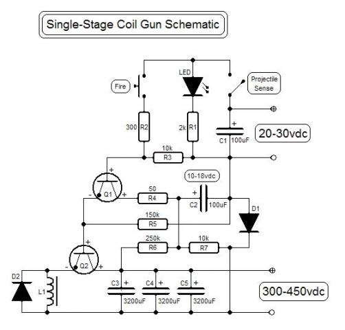

How many of you have built a coil gun???
I need some advice and/or guidance from the electrical engineers in the group. I have a pretty solid understanding of electronic design, but I often find myself second-guessing my layouts. I think having some other eyes on this would be helpful since my prototyping budget doesn't allow for many burned components...
Attached is a full schematic of the system I have in mind. I've gone over it several times trying to follow all the possible current paths and make sure there are no shorts, or any other undesired electrical activities.
The 20-30vdc supply is via an 8-cell A123 battery pack. The 300-450vdc is provided by a power inverter/voltage multiplier combo, which gets its power from the A123 pack. The "projectile sense" switch is a lever-actuated microswitch, located in the barrel ahead of the firing coil, and arms the gun when it is loaded while lighting an LED as indication. Resistor R3 is in place to keep the base of Q1 negative biased until the "fire" button is pressed. Capacitor C2 is charged to a potential of 10-18vdc, depending on the potential of C3-C5, by a voltage divider consisting of R6-R7. When the "fire" button is pressed, C1 discharges through R2 into the base of Q1, turning it on, which allows C2 to discharge into the base of Q2, which turns on, allowing C3-C5 to discharge through Q2 and L1. When the projectile has moved through L1 far enough to depress the "projectile sense" microswitch, the base of Q1 is again negative biased, turning it off. Q1 turning off then allows the base of Q2 to become negative biased once again through R5, halting the flow of current through L1. The residual EMF in L1 is shunted through D2, preventing any tug-back on the projectile and also protecting Q2 from transient voltage spikes.
At least, that's how it should work.

08.02.2011, 02:17 PM
Couple of things:
I hope you plan to use a Schottky diode for your back-EMF protection. Otherwise, it might not shunt the emf quick enough to protect your transistor and/or power source. Also, make sure Q2 has a C-E voltage of at least 500v.
How about using an optical switch instead of mechanical. Purely for reliability from a mechanical standpoint; just an LED and photosensor that triggers when the projectile breaks the beam.

08.02.2011, 02:45 PM
Thanks for your input, BG.
I attached the datasheets for what I had in mind for Q2 and the protection diodes.
The transistors have a C-E voltage of 1000V max, but the EMF will probably exceed that value so that's why the diode is still there.
The diodes are 1200V, 7.5kHZ; so <70uS response time. I was just thinking it may make sense to have a diode on the collector side as well to prevent the caps from being charged in reverse.
As far as mechanical vs. optical trigger, I'm still on the fence about it.

I fell off the fence. :) - 08.06.2011, 12:45 AM
On to what appears to be the right side based on my new, freshly revised, schematic.
I decided to go with an optical trigger on the projectile, as well as opto-isolation for the HV side of the circuit.

I actually have the shell of a nerf gun that I think it could be built into, sans the gigantic main capacitor.
I'll probably make the housing from polycarbonate since I have a good stock of it already. The circuit in the picture will fit onto a small (2"x3") PCB, which is nice because that will keep everything neat.
A small tip on the schematic- The pink lines represent the barrel of the gun. The zener diodes keep the system operating at exactly 12V to guarantee consistent operation.

08.07.2011, 04:34 AM
Revised.........again.
Now with component values!
...and the Zener diodes are correctly polarized!
Component selection is based in part on what I have in my inventory. If you can think of a more suitable component please let me know.
