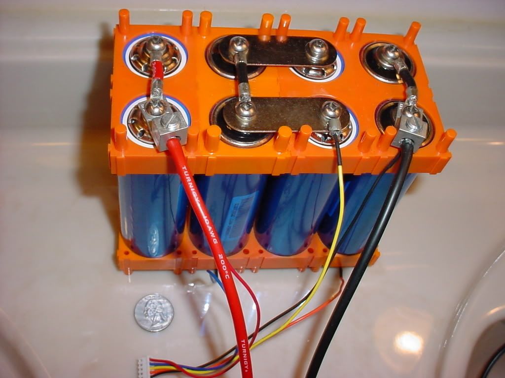

Anyone else try the larger scale Lifepo4 power?
I used this to power a 180 watt spider lamp earlier during a power outage, running an AC inverter, of course.
8 38120 10,000mah cells configured 4S2P
She puts out 20,000mah and so far, I'm impressed.
Each cell is 38mm X 120mm and are 10C cells. So each cell can give up 100amps continously.
Size reference? See the Quarter in the picture?

can you tell us any more? link to buy? where you got that handy 8 pack case? cost? what should I do with my life?

05.25.2011, 09:58 PM
http://stores.headway-headquarters.com/StoreFront.bok
They have them on Ebay also, but nothing local.
They sell the case and the hardware too.
I didn't have the smaller wire jumpers, so I made those.
More info? Specs maybe?
Headway 38120S(10AH) No.

I like the idea of using these cells to power an inverter but they're still expensive for that. I can get a marine battery to serve the same function and I have to imagine that an average marine battery has more than 10Ah and costs considerably less. Weight isn't an issue if it's sitting on the floor under my work bench!
Cost is an issue for me too and what you said makes perfect sense.
Curiousity got the best of me on this one. I've been wanting to experiment with these for a long time and finally found a good deal. $139 for the pack.
The shelf life is one thing that is very appealing to me.
If these do what they claim, it's a 10 year battery.
SLA trolling motor batteries only last me about 2 years.

I have since double sized the pack.
It is now 4S4P for a total of 40,000mah.
It will now run the trolling motor for an all day out of fishing and still have some charge left.
