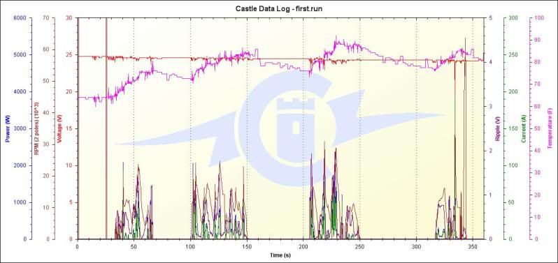

Since my tried and true MMMv2 decided to catch on fire...I stepped it up an purchased a XL2 for my Muggy conversion with a 1717 castle motor. So I did a short run today with a few blips of the throttle...no where near WOT. The XL2 is a beast; however, from the get go it does have some cogging. Settings are default.
I've read other posts and I am still not entirely sure if I'm calculating the ripple correctly.
Max ripple = 1.97V
Max voltage = 24.7 V, ave = 24.4, min = 19.4V
Max current = 239.3 amps
Max Watts = 4635
Temps were all low - logged max esc = 92 F
The run was with a 17T pinion with a 48T spur.
calculated ripple I get is 1.97/24.7 = 0.079 or 7.9% which I think is okay.
The only thing that worries me is the cogging, which is not horrible but it persists and my batteries are older Hyperion G3 Ex rated at 45C 5000Mah. I have the CC cappack, 8mm CC bullets on everything, and a CC pro BEC.

Not sure but i belive you have to navigate in the graph where the highest ripple occurred and read the voltage there, like not the use the max voltage.

When I look at the graph for maximum ripple the voltage is 24.1, so calculated ripple is 8.0, which is still reasonable...I'm worried about the cogging...I just have a feeling my lipo has gotten old? Think I'll order a new TP G6...

I disagree with you guys that 240A is really high -- if he's drawing 240A at top speed, then yes. But during acceleration currents can get REALLY high.
An Erevo brushless edition draws 400A during acceleration. Average current is only about 80A, but peaks are 400A+.
I think the datalogging feature will open some eyes to how much power these cars use.

I am not surprised by a 240 amp burst - this current lasts way less than a half second and isn't unheard of with a 4wd truck in high traction. The average draw will probably be less than 40 or 50 amps throughout a typical run(a 5000mah battery at 30 amps average draw will last less than 10minutes).
When using the data log, the sample rate makes a big impact on the draw that you actually see in the log - 10 samples/second will show much higher peaks typically than 5 samples/second or less, for instance - the peaks last a very short period of time usually. The 240 amp burst, for example, may show up as 150 amps if only sampling once per second.

Wow, 240Amps is a very high current for a Muggy on 6s. 4635Watts is more power than I've put through my 19lb. stretched Muggy geared for 50mph. But your setup looks OK - temps are good and ripple voltage is acceptable.

A question that (I think) has been raised before, but I'll ask you: How narrow are the current spikes that these trucks have on acceleration? If we are logging at the fastest rate available on the ICE controllers, could we still be missing the highest point of the spike?

So overall, it looks like my numbers are not horrible...but again I'm concerned about the start up cogging...my wheels/tires may be the issue, so I'll put the stock wheels and tires back on and try that before I drop $200 on a new battery.
