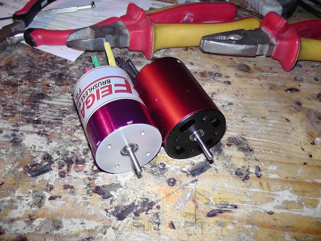

brushless motors .... 4 poles vs 2 poles - 01.14.2012, 06:36 PM
car rb5sp 4x2 1.8kg
lipo turnigy nano tech 3s 3300 3s 45c
esc ezrun sc8 without fan
pinion 19t
feigao 3650 3500kv 2 pole ............... 225gr ......... autonomy 18min ....... temp 46cº ....... top speed 56kmh
leopard lbp3650 3900kv 4 pole ....... 180gr ......... autonomy 24min ........ temp 34cº ..........top speed 61kmh

Pics of the motor internals please. What wind as the 4 pole motor?

soon I will make a vid with detailed photos and the car on the track ;)
