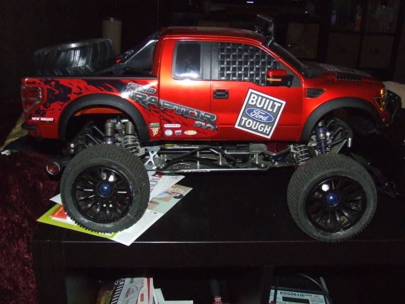

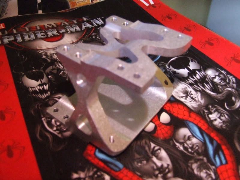

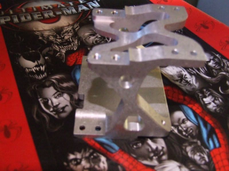

my beautiful unpolished monoblock, how cool is it unpolished ? Its friggin sick cool, anyone seen a bare baby like this ?
05.23.2012, 01:58 AM
did you sell your g-maxx? If not slap that monoblock on it
already has 1 mono on there, need 2 to fit that body + some big arse tires and finding a dog bone

05.23.2012, 10:09 PM

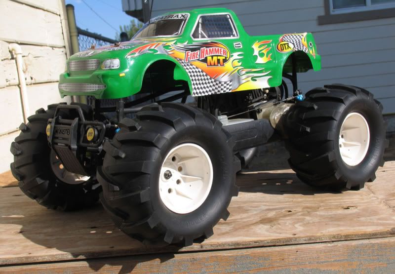

Love the raptor svt body! Losi claws might look alright.
Baja 5t tires might look good. They are 24mm hex so you would need 23mm hexes with a wrap of foil tape around them to run them.
I hope the second monoblock gives you the length you need. It might be a hair short yet.
I just got a new bright escalade body mounted on my buddy's son's rustler. I love the hard bodies

yeah it looks it will be too short, ill check to make sure when I get some more hex screws to mount #2 and big tires maybe it wont look bad. Plan B is I have a sheet of 4mm aluminum my neighbor gave me and I can cut 2 long pieces and make a mickey mouse long monoblock. I dog these new bright bodies, this one has 6 working lights ontop on the bar and headlights, but oddly no tail lights.
Are the losi claws 40 series ? It says 85mm wheel will fit. Iffin so they may be the one to try 1st, cheap on ebay

Losi Claw Mt tires were made for standard 3.2" MT rims.

boo that wont work, maybe the firehammers ?
05.24.2012, 01:32 AM
You can get 3.2" wheels with a 17mm hex and put on the losi claws. That's what I'm running on my xt8 truggy, it will go anywhere.

yes I have. You have to do some material removal on one of them in order to get them to mate properly, but it is easy to do with a Dremel tool. Once you create a tight fit the combination is pretty solid. Then you have to get your hands on a custom dog bone to cover the extra length. I cannot remember the measurements off the top of my head but that bad boy is long. I had mine made up by RCAlloys before they abandon us. The overall length of the vehicle makes it look almost like a 1/5 scale. Finding Monoblocks these days is getting harder and harder to accomplish, but Robin stated that he has a few unfinished sitting around in his shop waiting to get them done for sale. I think he said all they required was some holes and threads installed, but who knows when he might have time for that. He is knee deep in making parts for those monster 1:1 pickup trucks now. He's got to make some money some how. Have fun with the project man.
