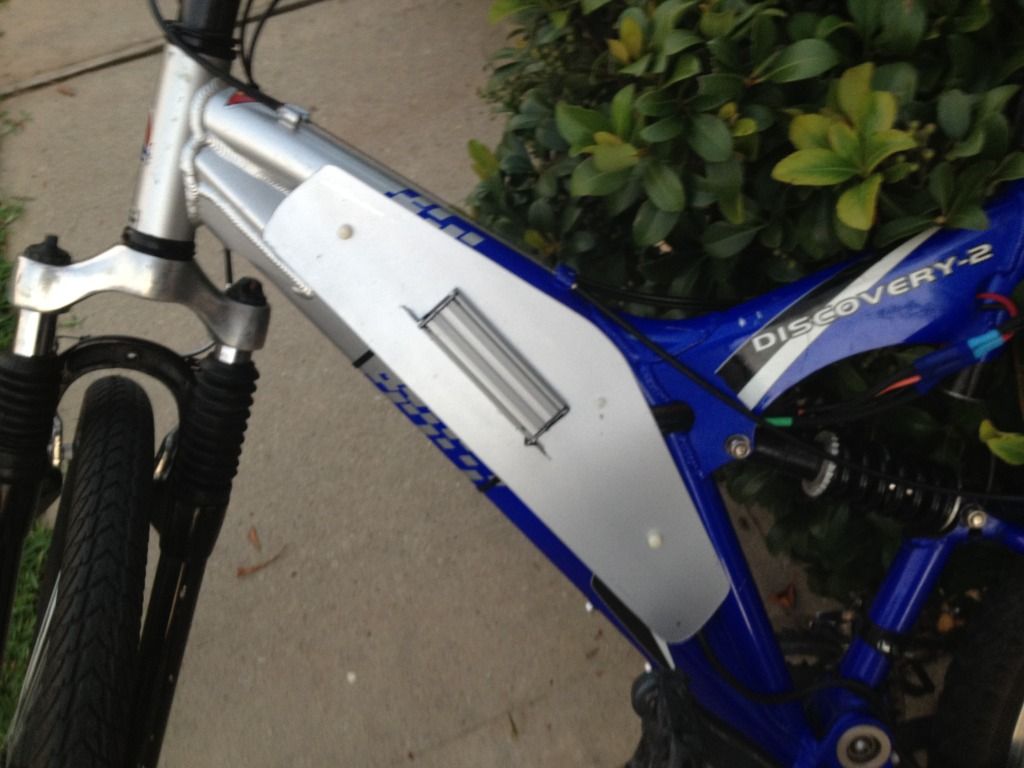

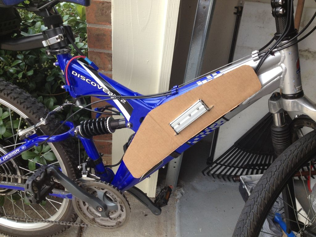

I converted my old ebike setup to a milder setup for the wife. She seems to like it now vs the older setup.
I'm using a Lyen 3077 6fet sensorless controller with my old Yescom 48v 500w motor. Battery power comes from 18s2p A123 and makes for a nice "assist". I got it up to 27mph. There is a 3 speed button and have still to add the on/off switch and regen button.
I put the ESC in the center of the bike, covered up the wires and the batteries are in the back.

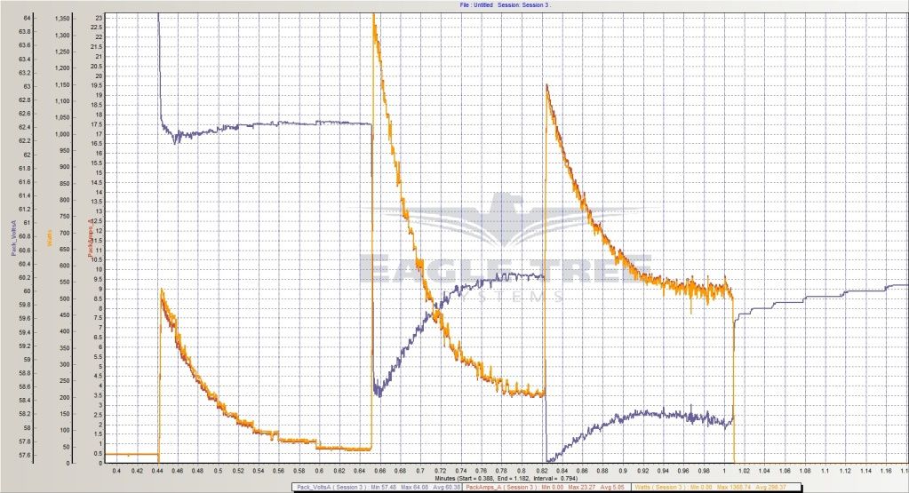

I data-logged the setup to see what kinda power the bike is pulling with me on it.
speed 1--> 1.09A
speed 2--> 3.66A
speed 3--> 9.62A

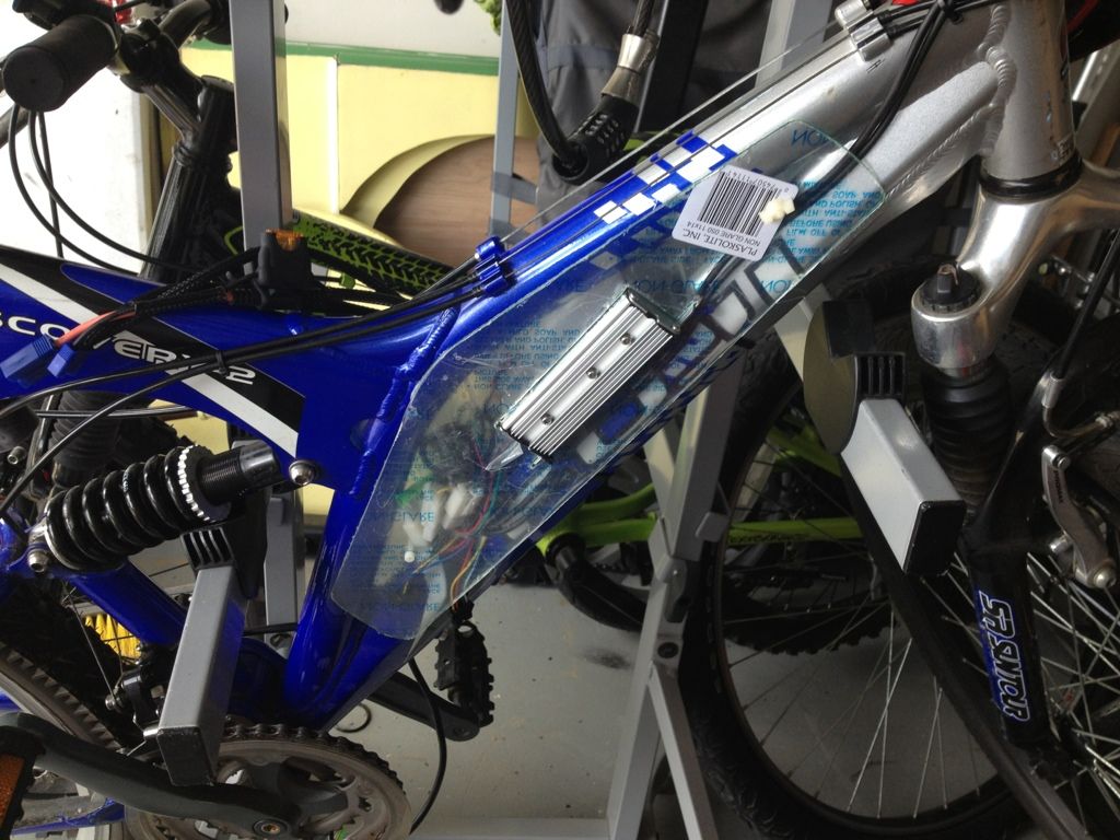

I cut up some new Lexan side covers for the bike. Batt A set at 25A and Phase @ 70A. 18s2p A123 battery pack. Took it out on the MTB trail for a quick shakedown test. Controller and motor behaved nicely. Top speed was 28.38mph and avg was 7.68mph.
I also added some additional braid wires on the power traces along the fets and shunt.
I'll be sending in the burned controller back for repair and fet upgrade.
