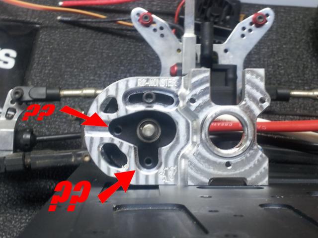

Hey guys....I picked up a motor mount from RCM about a week or so ago , but today I finally received my "black Friday " special MM 2200 system.
This is only going to be a basher rig ( hence why I picked up a MM kit )....but this is the first time I've put together an 1/8th electric and the first time I have ever used an RCM motor mount.
If you look at the pic below.....what am I missing? I know that the top bolt will adjust the mesh between my pinion and spur gear.....but how do I mount bolts to the other two? There is a big gap there....am I supposed to use some special bolt or something? I could use some advice....or even better yet , a pic so I know what I'm looking at.
I really want to get this rig put together just to "see if I can ".....she is going to be one tough , heavy baddass SOB when I'm done with her!

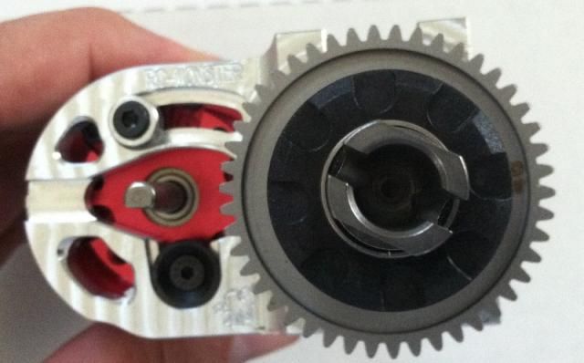

The motor only mounts with the top and bottom screws, the middle third one is not used. Only 2 screws to mount it.
You should have received some other small parts with the motor mount, a black metal pivot bushing and an aluminum washer. The pivot bushing goes in the bottom and the aluminum washer is used on the adjustable top part.
I hope this makes sense. Here's a pic:

Oh DOH!!! .....I didn't even see those two little bushing and washers in that little bag. Now that makes sense. I was sitting there scratching my head thinking " wth?".
