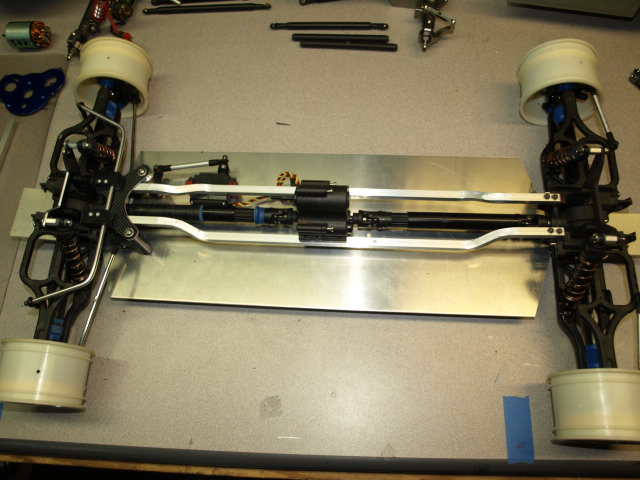

Here's my build:
Watch here as I transform once a Emaxx crawler into a HUGE 1/5 scale High Power Brushless Lipo powered 45+ MPH On-road Drift Car and Rally jumping 4WD sedan
Always Wanted a BIG RC !:-P
Parts on hand
1/5 scale Sedan Body- free
E maxx Axles assemblies,
lockers
A arms- 15" wide
Revo shafts & knuckles
Emaxx 2 speed Tranny
emaxx shocks
Custom made chassis Alum.
ESC Mamba Max

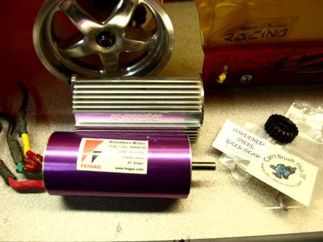

Just bought :
RC monster Steel Idler gear
Motor Feigao 7XL 2382 KV
HPI steering assembly
2.5 mm T6 aluminum for chassis
Wheel base 20.5"
Width 16"
Length 36"
Height 9.5"

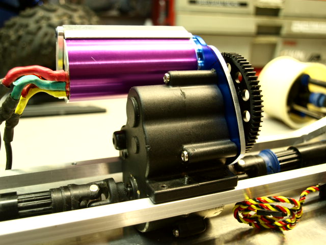

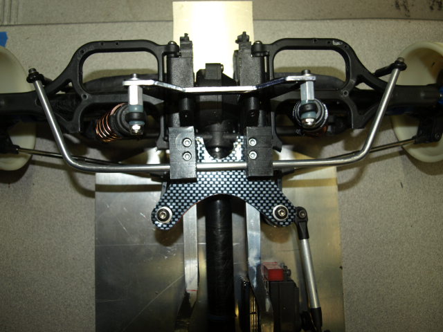

Preparations:
Emaxx Tranny locked in 2nd
upgraded idler gear
1st gears removed
Emaxx axles locked
Feigao 7XL 2382 Kv motor
Mamba Max
Thank you

12.05.2008, 09:33 PM
you definately do not want locked diffs. It will snap your axles and make it turn like a bus.(your inside wheels need to turn rotate slower than the outside in a turn.) The only tires I know of for monster trucks are pro-lines road rages, IMO they suck though. Maybe 17mm adapters and buggy wheels? We can't determine spur/pinion until we know what motor you'll use, what batteries you'll use, and how fast you want to go. Good Luck, and welcome to the forums!

12.05.2008, 10:17 PM
oh , ok thanks. I thought that's what I would need for drifting and hard pack off-road rally driving , No?
if change to differential what weight of fluid should I put in diff ?
Thank you
oh the motor is Feigao 7xl 2382 kv
Looking for mostly power torque speed would be nice in the 40's
Found this AWESOME SPEED/Motor Calculator but it's hard to figure what gear set
Looking for a 5mm shaft pinion , not sure what size tooth pinion though, any suggestions.

Great looking project, I’ll be looking forward to watching it progress. A few Q &A for you??
1. Those front and rear drive lines are long.. How did you do that (It looks like to cut up a bunch of 3905 drivelines and made one long one ??) just and FYI If you ever need custom t – bones made up just PM Jordan.. He’ll hook you up with his guy who did his..
2. I think the 3905 Trans is rated @ 6s Max so at least you know your limitations there are
3. What diffs are you using ??? the stock 3905 ones or will you be installing these ?? http://www.rc-monster.com/proddetail...RO_DIFF&cat=17
4. I'm assuming that you want some large tires for it so here a link to some 23mm hubs. Or use 17 mm like Paralyzed motioned below. http://www.impaktrc.com/advanced_sea...0e44341af7ef3f
5. I have no idea on the type of tire sorry but Ryo-James will know!!! He’s building a killer 5th scale too here is his thread if you wanted to see how he’s doing it?? http://www.rc-monster.com/forum/showthread.php?t=16158
6. Two 3s 5000 lipo’s should work great, but you will need a MMM V3 or a MGM controller / ESC try here: http://www.rc-monster.com/brushlesscontrollers.php
7. lipo’s here: http://www.rc-monster.com/batteries.php or here: https://www.hobbycity.com/hobbycity/...idProduct=6350
8. You’ll need a good strong servo so I’d go with JR 8711 440 oz or the Airtronics @ 423 oz both digital, metal gear ect..
That’s about all I can think of now sorry!.. OOo 7k in the front diffs and 3-5k in the rear is what oil i use in my trucks..
Hope that helps and have a great weekend
Shaun.

1. they are Revo's cut and used 2 to get the length. outer, innner, outer inner outer to trans
Thank you for the name of where to get stronger ones . I saw those in jordans build.
2. the trans is an old emaxx not 3905, but I like the Laydown option of the Xray b808 diff.
3. diffs are stock with spools. should I go back to Diffs? maybe use Ofna Diffs. cant afford the Hotboddies right now, I was laid off my 10yr job a few months ago and finding another job has been tough.
4.5. I'll check that out.
6. Cant afford a new ESC right now, but thank you for your input.
7. my Mamba max can only handle two 2s lipo, but I will look into those as I will Always Progress in this build as money will allow.
8.Servo will be a Airtronics 400oz or a Hitec 5955 that I have
Thank so much again . You are the man !

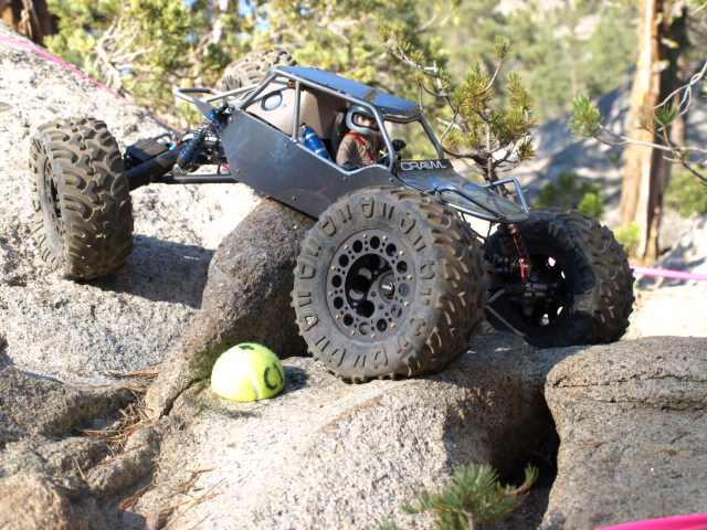

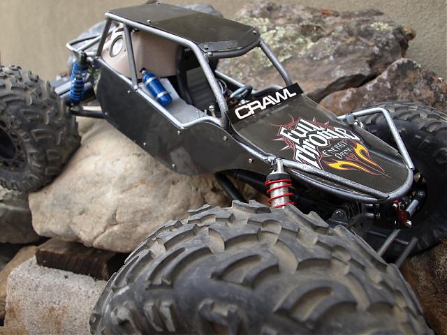

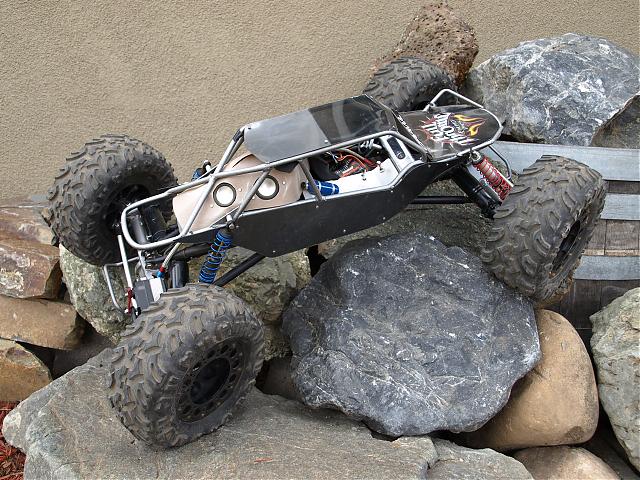

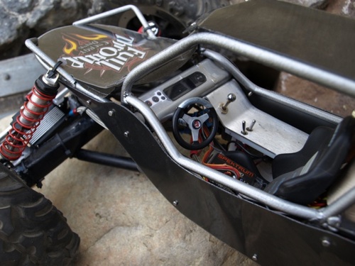

I'm stealing the MM out of my Latest Creation Full Throttle custom Super Crawler, build thread just added to my sig, it's got 6 watt 4 speaker MP3 stereo loaded in it complete with Real V8 engine sound.
Here's a sneak peek
My latest creation below
Console shifter turns car on
twin stick turns on stereo Amplifier
Sony MP3 with Tunes and Real V8 engine sound
18" wheel base 14" wide
Axial trans
Revo drive shafts
Losi aftershock Diffs, custom lockers
Hyper 8 shafts
Xtm hubs
custom SS axle tubes and Knuckles
1/4 Tube steel MIG welded Chassis
2wd, 4wd and DIG by Remote
HiTec 7955 front rear steering servos
Castle bec
Mamba max
Climbs great when tires are working, Moabs stink
