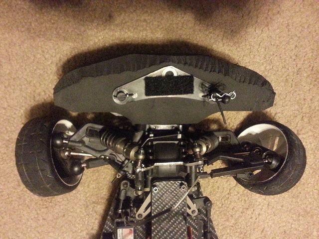

Yeah I stole that from the Six million dollar man because that is how I feel. On what began as a beautiful run up to 102mph, I didn't get out of it soon enough and he caught a curb, caught air and ended that run. The damage was extensive and the total. The good thing though, all the electronics are still fully functional. Back to the lab...

Serum....I like the speed...and that was my goal...100 plus on 6s. And I thought it was worse as well until I saw it up close. The carbon fiber didn't break at all...the plastic and aluminum parts did. When I build them...I build to last.

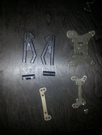

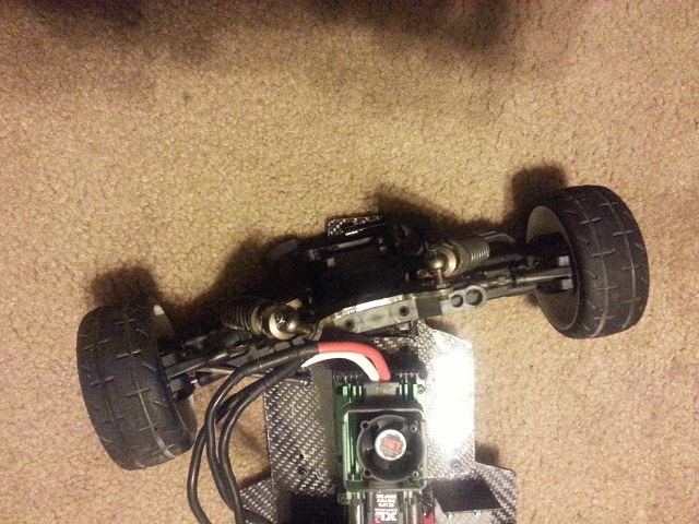

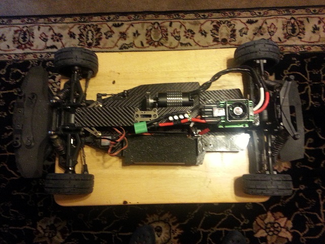

I finally got a chance to tear down the wreckage and it wasn’t nearly as bad as it looked. *The chassis is completely intact. *The 4.4mm CF chassis Held up beautifully against the curb and was wholly undamaged. *The plastic and aluminum parts though, I cannot say the say. *The damage tallied to be:
The front and rear lower arm holder plates
The front upper arms
The front and rear shock posts
The 3mm screws were stripped out of the front and rear gear boxes
I plan on fixing the stripped screws buy re-tapping with 4mm screw, as well as cutting out my own replacement shock mounts made from the same chassis material.

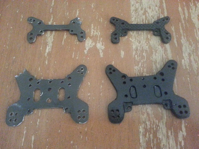

The casualties of the crash and the new stuff
Big House
Big House's Avatar
Posts: 372
The casualties of the crash and the new stuff - 06.20.2015, 04:17 PM
I thought it would have been worst. Only broke a few things and the best part, the front and rear shocks have already be re-built, better than ever. 4mm carbon fiber, this is not breaking.

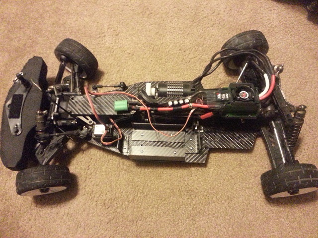

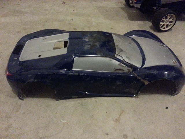

The Beast -Back and better than ever... - 08.06.2015, 10:52 PM
After about a month and a half of cutting, trimming, painting, testing and glassing, the monster is back and better than ever. Changed the gearing to go faster and the color to see better at longer distances, the Beast is ready.
