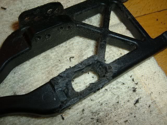

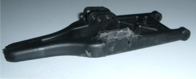

On the stock lower arms the bottom shock mount screw holes are raised up. If you were to cut these off and have the shocks mount onto the arm like a truggy. There is just a hole cut out in the arm for them to fit in and a hole for the screw. It would mean that the shocks would have to be about 15mm longer or so, to fit perfectly. I'm not sure how long the UE ones are.

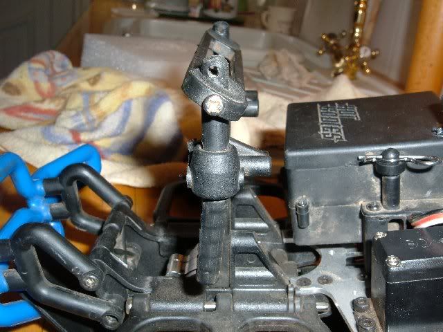

Darren
07.15.2006, 03:52 PM
This is what I was meaning, if you can see it properly, it was only a rough attempt, final version will be done better.

07.15.2006, 06:52 PM
I would try to go farther out towards the pillow ball.
Make it closer to the outer hole that you cut off.

can't you just flip the arms around?
Darren
07.16.2006, 05:36 AM

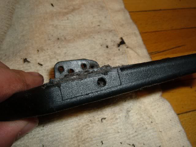

Sure will, that's just a silly little prototype to see if you all caught my drift.
Serum - Id still have to dremel material none the less.

Yeah, sounds fair to me, i guess it's the angle of the shock that gets in the way of the arm.

07.21.2006, 01:40 PM

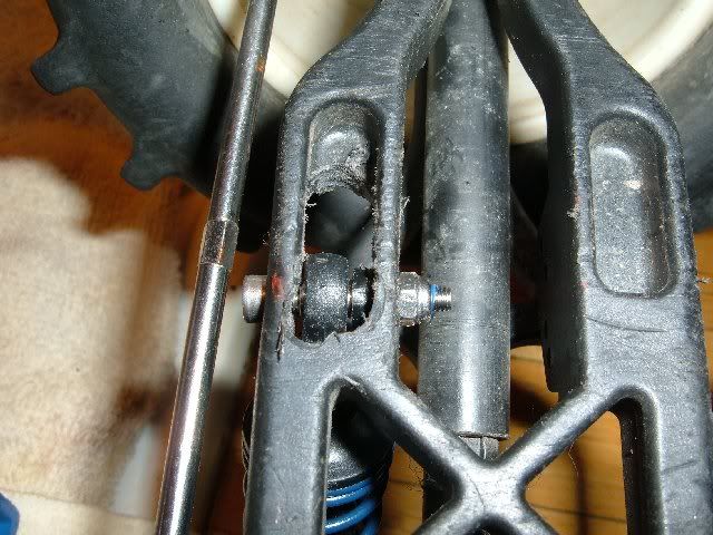

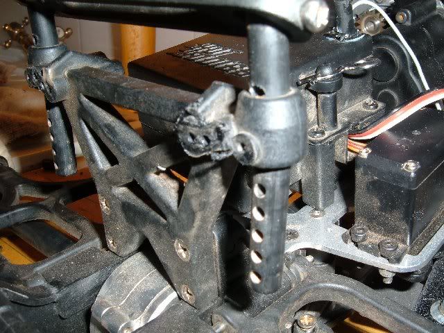

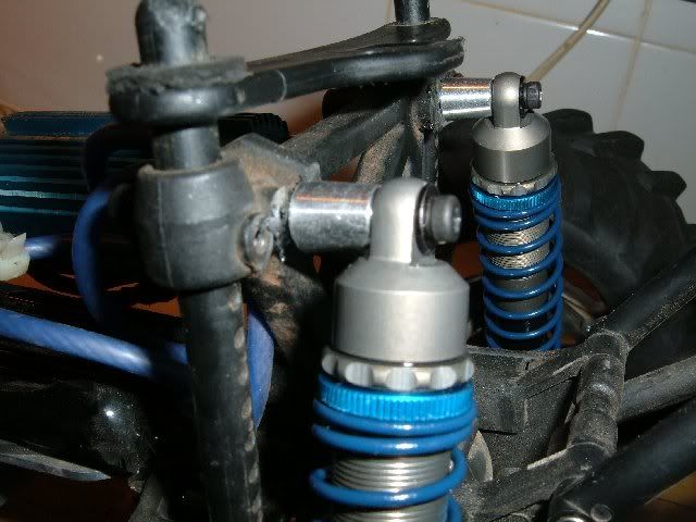

Yay, I made it work!
Gonna post a little 'How To' on the UE Forum later.
Comments/flames/criticism etc... encouraged :) .

07.21.2006, 01:51 PM
Look's like you need to get some more practice with the 'ol dremel lol.
j/k nice mod. Hope your arm's won't fold if you land a jump hard lol.

Wouldn't it have been easier to get some front buggy shocks.

Darren
07.21.2006, 04:34 PM
Sneeck, I probably could, but it works.
CHC - I dunno, but I like the fact that they're UE. First UE part i've bought :) .

07.24.2006, 11:12 AM
now that you made new holes darren, everything is on there but not every hole is in the exact position and now isn't the arm weakened by shaving more plastic off. I would understand if you used rpm.

07.24.2006, 05:26 PM
Pick up a used set of UE Widemaxx arms for $100. It will look and work much better!
