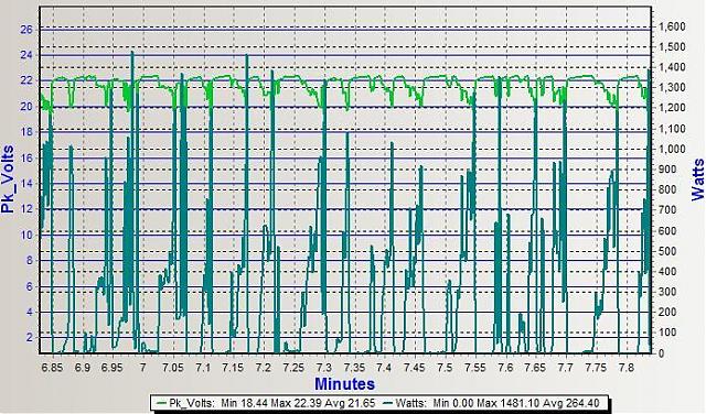

- Vehicle type; 2/4wd, ST/MT/etc. -Revo 3.3 MT
- Approximate RTR vehicle weight in pounds -9.5lbs
- Drive style (racing/bashing) -hard bashing
- Top speed in mph (approximate) -40mph
- Battery capacity in Ah -2.3Ah (measured at 2.5Ah)
- Runtime in minutes -13 - 15 mins
Other data:
gearing: stock transmission w/13T pinion
motor: 1512/3D
battery: A123 7s1p pack
- Peak current draw (this is where the e-logger is needed).
