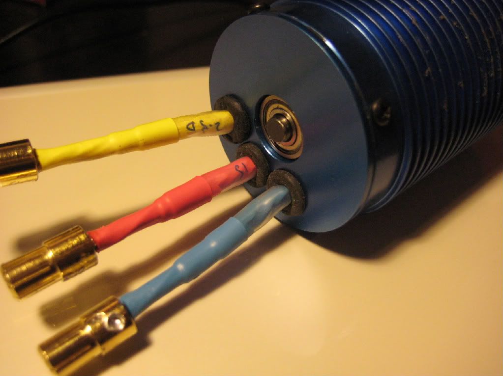

If your Neu does not have gromets around the power wires coming out of the rear end bell, why not add them? Seemed simple enough. Your thoughts?
04.18.2009, 05:35 PM
Looks good and simple to do. Where do you get those grommets? I have a bunch but can't remember where I got them. I usually just use an extra layer or two of heatshrink.

Gromets came from Lowes. They're over priced and I expect you could get a handful from ebay for much less.

That looks real nice. I did a couple layers of heatshrink as well. You do plan on heatshrink on those plugs I hope.

Yeah, already done. I had the idea to stick some grommets in there AFTER I had the connectons done. I unsoldered the bullet connectors, put the grommets in, and put the connectors back on.

hey william whats the size you used? i need to do this when i wire my truggy tomorrow, and those gromets look better than my split fuel tubing on my wires....

Package says 11/32 OD x 1/8 ID
They are a tight fit and take a bit of work to get in. Worlds easier if you have the endbell off, put the grommets in, and lastly put the wires through.
