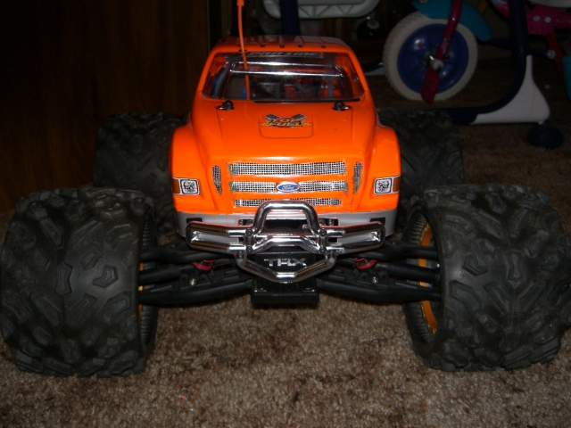

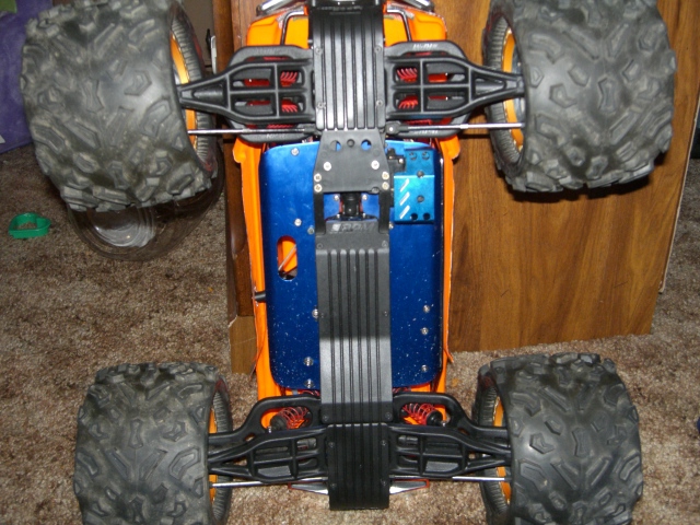

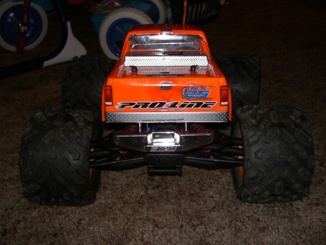

I agree with biddy but I went with the rpm a arms all around, full skid plates, front and rear shock towers ( the only thing bad about them is only one shock mounting position one them compared to the 3 on the stock ) and also the bumpers and bulkhead braces

I just dont like the way they look, makes a truck look like a cheap radioshack toy. I would never recommend a metal bumper AND braces though, since any shock caused by a crash is transfered through to the bulkheads and chassis, not good.

rpm are not metal they are basically a heavy duty plastic
