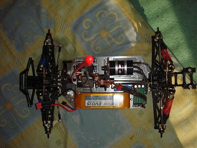

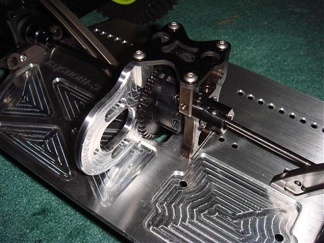

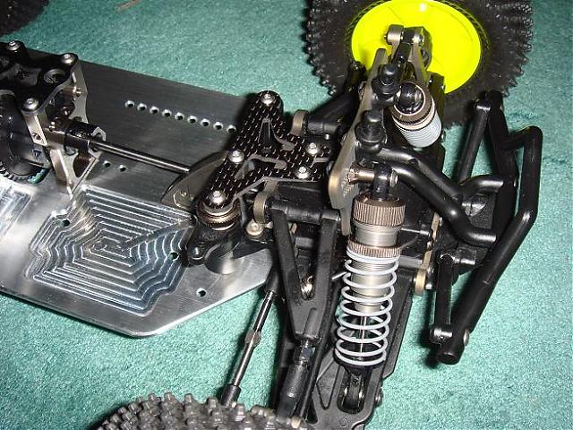

Okay, here's the little truggy everyone is converting to brushless nowadays.
This one is completely hopped up with all of Jammin's alu parts and a few things from lunsford and acer racing. RC-Monster's chassis made the little truggy turn into a sharp looking racing star. I have a 1930/5 which I've bought from FDM a long time ago and decided to put it in this thing with the Mamba Max, Castle's BEC and a 4s FP Evo25 2500mah lipo. Using 13T pinion and 46 spur gear. The wheelies are simply amazing and the tires are ballooning up to mid size pan pizza.:)
Thanks to Mike and BP Revo for such a nice thing. Definitely one of the nicest projects I've done.
Some pics:

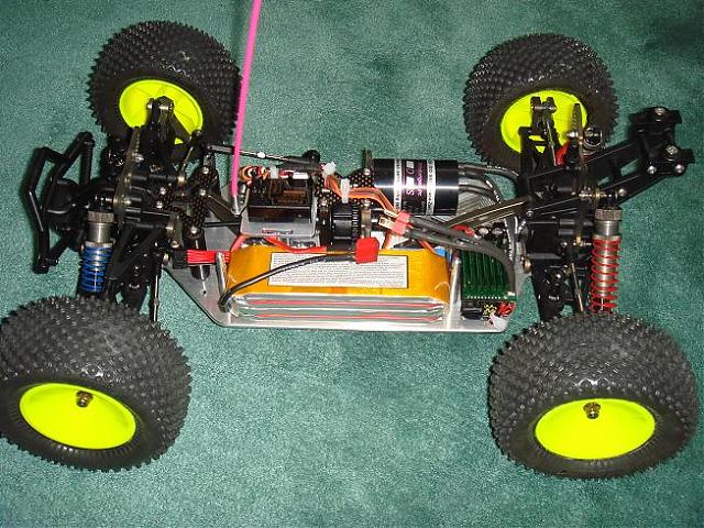

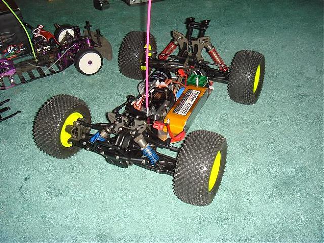

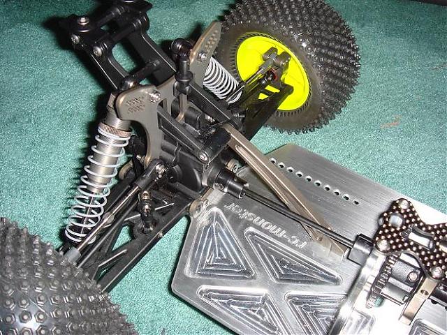

With the electronics in:

Thanks alot for the nice complements, Serum, rc-hippies, cemetery gates and Bro.:)
The 2500mah pack is holding quite fine. For something like 7-10 minutes. The 1930/5 needs a real big deal to make it happy, but the 2500mah 4s1p is doing just fine for a basher. I have another 2500mah pack as a back up.
I'm using proline's lug nut Truck tires on the CRT.5 buggy rims. That's one of the reasons why the tires are ballooning like crazy. I delibrately did not use duct tapes to see how much the tires can balloon. I SWEAR, dude, just a touch over half throttle and the tires' beads started to tear out of the wheels and became as big as one's palm.
