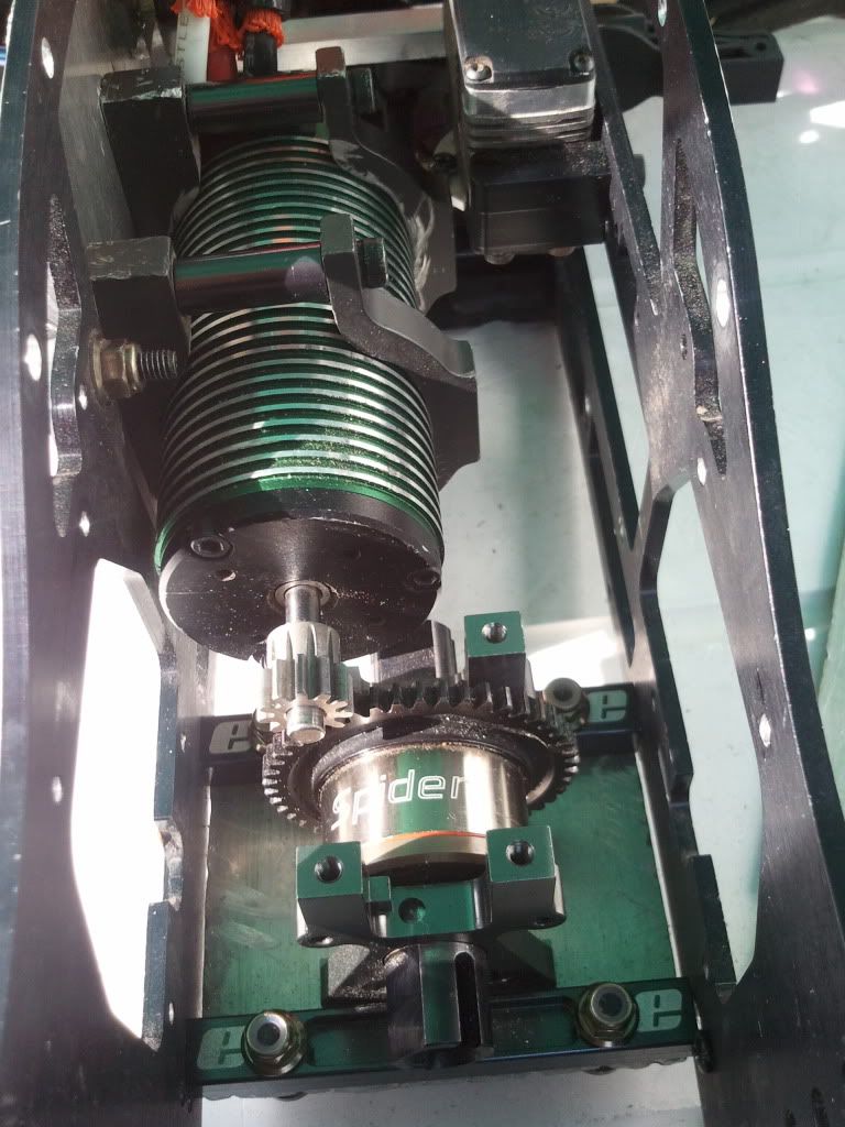

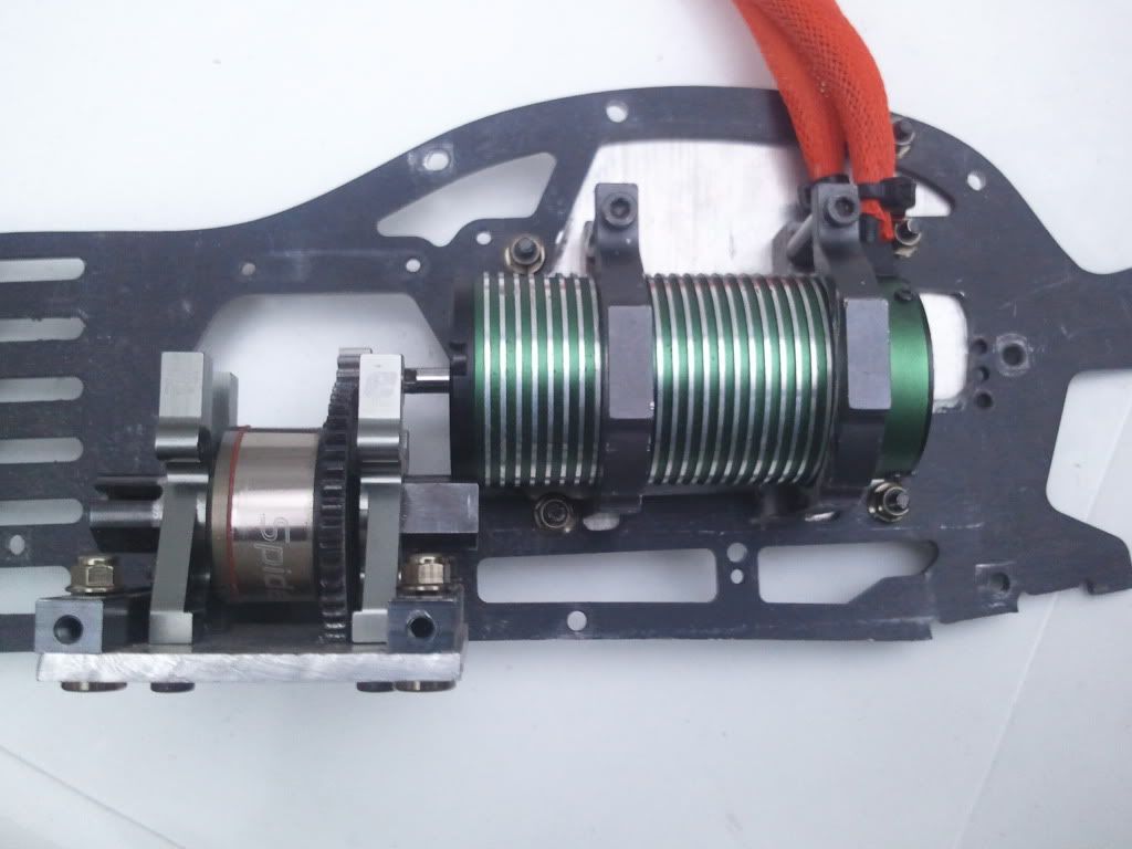

i am already taking this esc into considering, i am seriously working out a way i can mount a braking system to my centre diff... But i am trying to get around how i can fit it all in as my motor doesnt sit parallel to the centre diff and the limited space in the tvps means i cant have a servo sitting directly next to the centre to control the brake mech.
Any advice would be much appreciated.
and consider how most systems operate...
any ideas where i could take a more appropriate system from?

01.25.2011, 11:39 AM
Looked at your pics some more.
I think you could easily modify your design and gain the necessary clearance to install the brake disks, and the servo/linkage.
What you need to do is make a new plate, move the chassis braces forward and backward to make room for the disks. Then you can mount the servo on the outside of the tvps and run the linkages thru the tvp transmission hole that is across from the center diff.
I am referring to this pic:
Move the square braces forward and backward and make the plate longer to gain clearance for the disks on the front and rear diff outputs.
