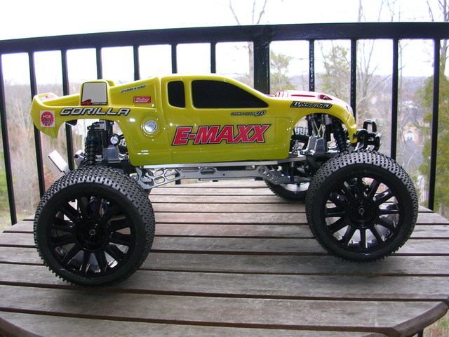

Dyed a set of BIG wheels for the first time. They turned out pretty well I guess. I'm going to dye a set of chrome wheels next. Wish me luck.
The paintjob was only my second attempt at painting lexan. I literally had it purchased, prep'd, painted, and peppered with decals in under 24hrs. It was to be my bash body.

03.01.2008, 05:09 PM
Don't count on the dye sticking to the chrome very well from my past experience. Sometimes it works and tints the chrome. Looks nice if you can get it to work.
Good luck!

good job doug. looks like you won't need my help (or Rit) after all, 'eh? that's ok, i STILL don't have my Xray back yet to dye mine. almost 3 months i think?
anyhow, your ride looks mean. as usual.

Yeah, but that was with the black wheels. Your SM truck was a real inspiration. Now I'm ready to go Blood Red on the next dye job, sound familiar?
Even managed to scare up a bnib discontinued ProLine VW Baja Body.
