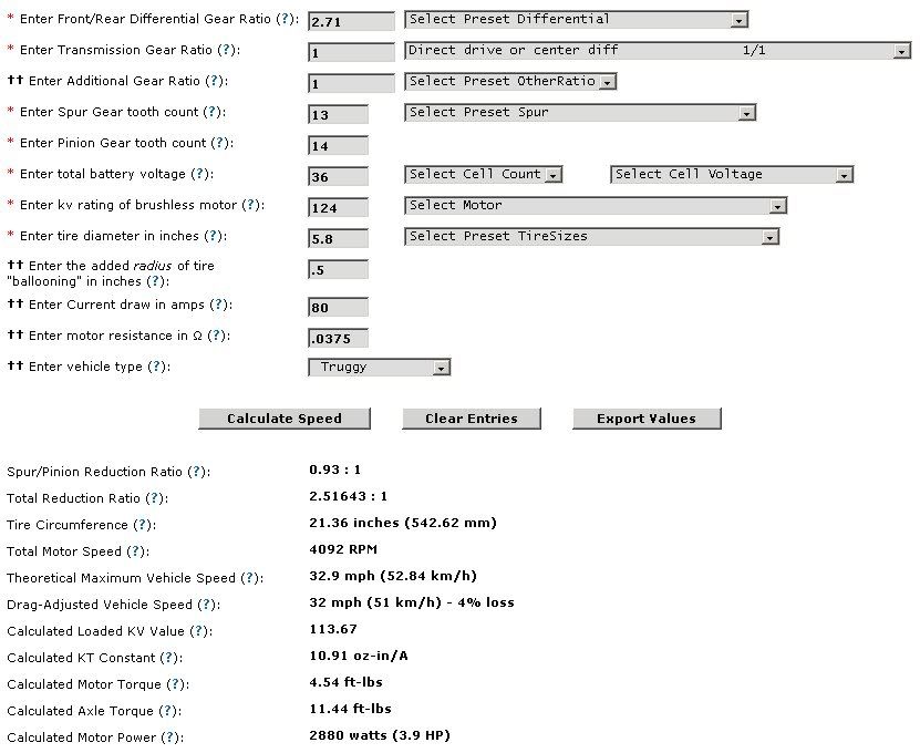

The 100w is rated differently than any brushless motor you guys have on the forum thats used in an r/c. Its all torque like lutach and a few others have stated before and no big amp draw so it spools up very fast and then conserves energy. So it will have gutwrenching power, and the rpm rating doesnt bother me because I have that all figured out. It will be around 4100rpm total with a 14t pinion and a 13t spur "chain driven". I already calculated all this out...
RIP- Tammy (9/14/08)
