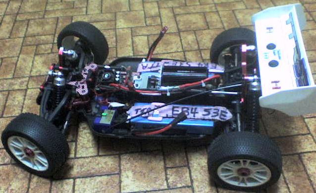

I made my own mount for my S3 over the dif and flex is a big issue. The S3 had a channel down the center so I added a convex rubber pad under the end of the motor to absorb some of the impact, but the pinion still showed wear. I tried to talk Mike into making me a mount for a Team Magic buggy and after he desribed how much of a pain and the downfalls, I went with his RC8 mount.
the pic was taken with a cel so not the best. I had 2 of these buggies, and the nitro I used the extended chassis. the stiffness of the S3 chassis with the channel and the centre line drivetrain made this my option and it balanced good. I sold/traded them to a buddy to get another brushless buggy in the group to race and started the next one. yes it has pink sorta straps, so is that ugly carbon though so it matched LOL

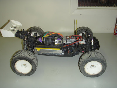

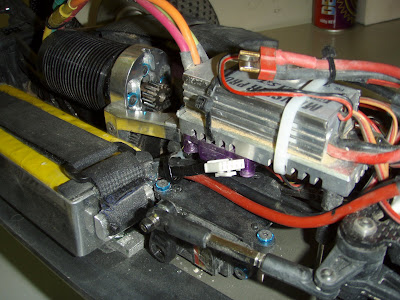

I made a mount for my Thunder Tiger ST-1 Pro with the motor over the center diff. I didn't really want 5s2p 8000mahs on one side, too much weight and I don't think a pack that big is well protected by the body. I dented the top of the 3s pack in a crash, don't know how bad it would have been if I had a tall battery there.
