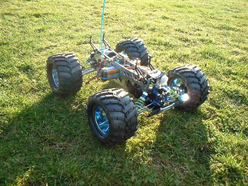

The Dagger is a "dual only" truck, Dafni...twin gearboxes. Running one motor would result in 2WD, wich would suck, lol. Here's my machine (it's a very outdated pic but it gives the idea anyway...front and rear motors):
She'll weigh in at 3.5-4.0kg with the 16 cells, new chassis etc. Aha! Wait a minute, I have an idea. I could stick with the 16S motors and 16 cells (two 8 cell packs in series), but have two Warrior/MGM controllers sharing the full 19.2V of power. The cells should be able to handle the amp draw without a problem and the controllers will be running well within their limits. It will be more expensive but it should run well. How about that setup?
