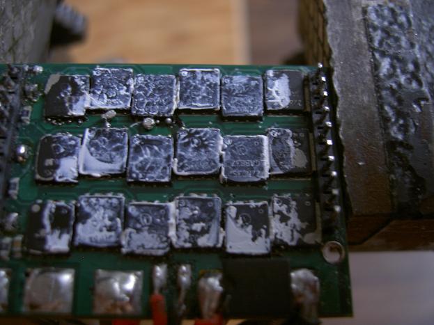

I recently sent Griffinru a MM and had him do his "stage 1" mods to it. Upon receiving it from him I had a good look at it. His workmanship is very nice and clean, all mods are stock appearing and well executed. Basically the intent of the mods is to keep the esc cooler and help it to handle higher voltage. My first tests are with 4s lipo, I will try 5s lipo as well.
