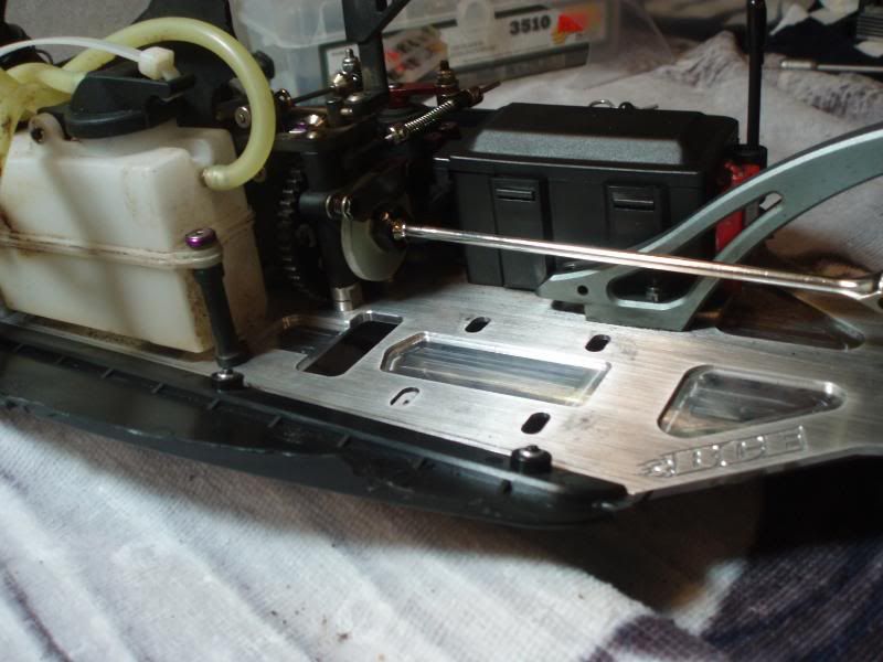

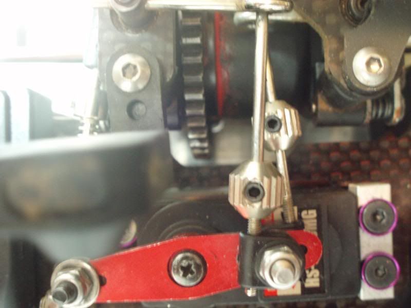

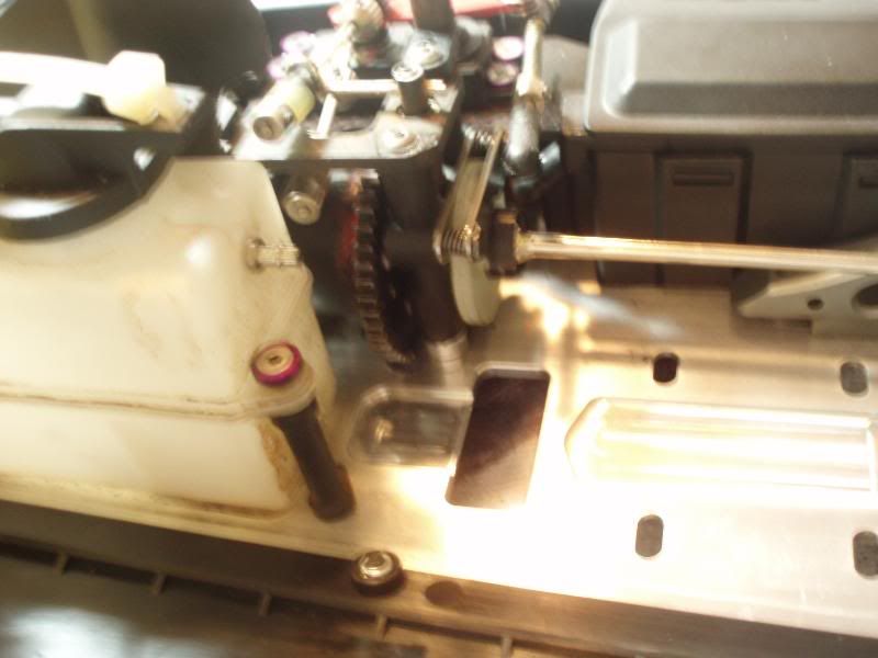

BCE has been working on a chassis kit for the Hyper ST and its almost ready. The are planning to drop the spur to 46T from 52T and ditch the center brace. On mine I already dropped to a 46T spur as BL has enough power to pull the gearing. I left the C brace in tho. The spur doesn't even come down to the chassis level. Only downside is the Neu is so wide I can only fit a 14 or 15T pinion as the smallest gear on there due to the rear brace.
A few things have been pulled in as well. Looks like a nice kit:

looks sweet (are they going to make a electric chassis ?) , me and a friend engineer have produced a top mount motor plate and we run the 46 spur , this provides a perfect weight balance and a option of split cells are now available (2s in series or even as pictured 4s2p) also got plans for a 8s setup once i find a suitable speedy
picture is only a prototype but we now have a final design we are happy with

The nice thing should be is that for BL use all you really should need is the chassis. The other diffs are to get a lower FDR w/ the nitro engine, but you shouldn't have to do this w/ BL. The motors have more TQ, Mike's mount puts them close, and if you had a 36mm can you could prolly gear as low as 12/46 or less no probs. I'm currently 15/46 on my 2.5D. I got a 46T and another 48T spur coming from a hyper 8 for ~$25. I should be able to gear 13/48 w/ the Neu. So really all you'd need is the chassis if you were so inclined. $100 maybe?

IIRC you had to grind your Neu to get it to fit with the 46T if you go to 5s you are going to have even more fit issues if you don't want to fo 20% quicker... The 48 will give you another 2mm clearance I guess
