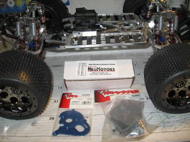

Didn't take long

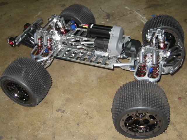

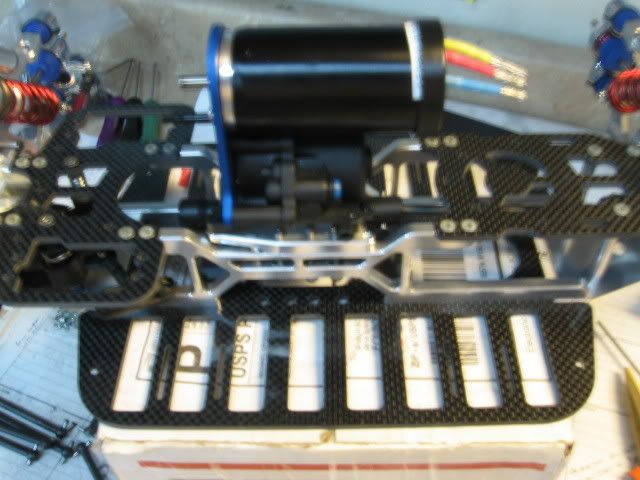

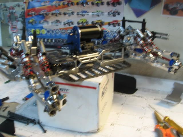

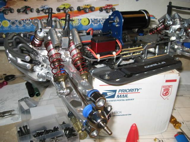

Yes that was my truck you saw it on and Mike should be able to get you the part. The part Number is FLM 10600 it sold for 17 + shipping.
I removed it from my FLM chassis and installed it on a my G3. build. So it pretty much interchangeable between the GM and FLM.. The GM requires some new drilling to fit and will limit you to a 44 spur gear though..

Hey TDC what knuckles do you have on that rig?

I hate to admit it out loud! But they are Integy.. Part number is T3016 they cost me $76.00 for all four..

Hey TDC, did u have to do anything special to get that waterproof reciever box attached to the FLM emaxx chassis?

If your planning on using the duel steering servos then you will need to cutoff the end of the 3905 rx box (IE) the part that holds down the wires going into the box.
If you plan on using a single steering servo then no issues (piece of cake) it wont be centered like it is shown but it provide you with a full water protection and (heck) a little offset never hearts anything.

You’re going to love the JR servo.. I’ve always had great success with mine. I’ve got the JR DS8711 in both of my builds.. I just love the 400 oz of torque it provides.. I stripped my anodized off for my GEVO
But left it on my G3
