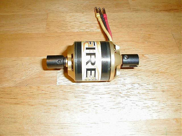

I've got my motor. I've centered the motor shaft (thanks Takedown) and have temporarily mounted the drive cups to it. I find myself in need of 2-6mmto5mm bore reducers and a motor mount to mount it to my MP-6. Is this something Mike could come up with? Thanks, Don

06.13.2008, 11:26 PM
Yeah, Mike should be able to make the bore reducers.
