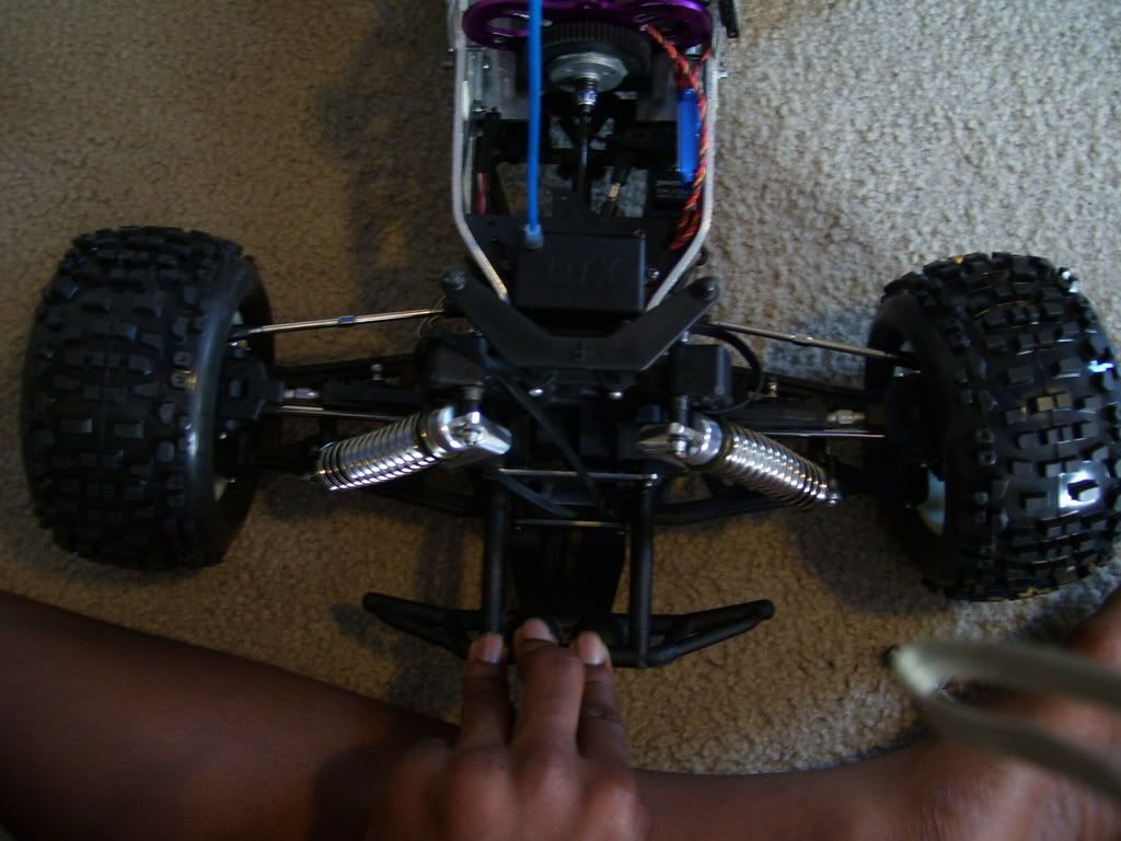

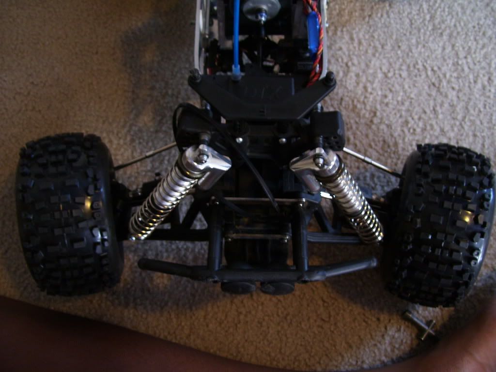

Hey guys, i just got my warhead back together and am experiencing and odd problem. when the suspension is full extended the front wheels are toed-in very aggressively but as i cycle the suspension the wheels become parrallel then toe-out when the suspension is fully compressed.. how can i fix this (if i can fix it)?

hi mate i think this is called bump steer this may work if you put the toe link bars where they bolt to the hub on the bottom of the hub instead of the top or other way round not sure what way you have them
hope this helps

ah i knew i for got the name (bump steer) thanks lind5 ill try that right now-they were above the hubs.

thank you lind5 that was the problem and its all better now :D
