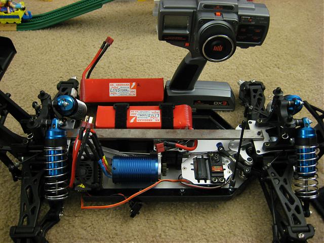

How about some pictures of your setup? Some closeups would be nice.

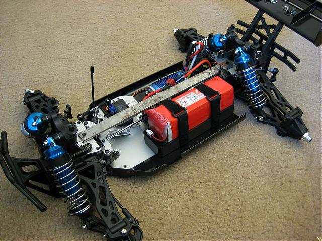

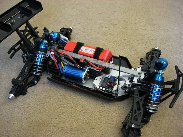

My setup:
Muggy with some tasteful mods ;)
Spektrum DX3
Spektrum pro Rx
Futaba S9351 digital steering servo
MMM v2
Tekno Neu 1515 1Y (2200kv)
Hyperion 6S 4800mah 20-30C
Hyperion charger w/ built in balancer
deans plugs
18T pinion + RCM motor mount + battery tray
all radio settings on 0.
the motor connections have heat shrink tubing on them, so nothing can touch to short. all connections were made this way, for this reason. I have ZERO intention of blowing anything up!! I'll admit I'm not the best with the soldering iron, but my connections are good enough for sure.
I don't know if the MMM was hot; by the time the shock had worn off me and the tech and he asked me to check it, it seemed only a few degrees higher than ambient.
pics are attached............

A pic of the rec with the wires in it would be good too. Sinal wire is usually toward the center of the case, ground wire goes to the outside of the case.
