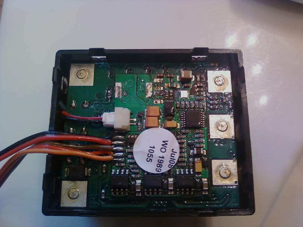

To do the opto mod on my MMM, i tried and apparently i failed...
All the LED's work. it responds to throttle commands, the fan comes on and nothings smoking or getting hot (all ambient temp) but the thing wont arm or beep or anything tried with the switch on and off.

First, take a really large, clear picture of the modded area and post it. Much easier that way instead of speculating what might have happened.

well its already been voided- pic up in a minute

lighting makes it look worste then it is, ther areent any shorts
09.02.2008, 07:00 PM
Hmm, it's kinda hard to tell, but I don't see any solder bridges anywhere. It looks like you did overheat a couple of the traces in the upper right corner (10 pin IC), but those should not matter since the IC is out... unless they are paths to other spots in the circuit using vias on another layer...
09.02.2008, 07:29 PM
Triple check for shorts - It is odd if the brain board is getting power but not powering the FETS...

Brushlessboy, Im not sure if its the same with you but I notice the same behavior when I first tried the mod then out of curiosity I turned on/off the switch and it finally armed. Thats when I decided to short out the switch connection, really no use. off position still show blinking light like trying to arm.
I am not one hundred percent sure though, hard to see if there are any short on your ESC...if you have a tester might want to try also

i have tested multimle times- no shorts
the leds arm, as in they flash all three colors then go to green and respond to the trigger
