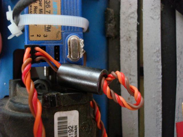

Other methods to reduce/eliminate RFI is to use a ferrite bead or donut around the wire, use a capacitor on the power wire (if it is entering that way), and of course, moving things around to get the low-voltage wires and antenna well away from any high current wires.

09.17.2008, 06:48 PM
ok brian g would a ferrite ring be in a power cord or usb cord or anything that is a cord that has a extra lump near the ends of it and looks like a magnet when you cut it out
and if so does the esc wire have to run through it or can i make a loop and shove that through it as the picks show
thanks
