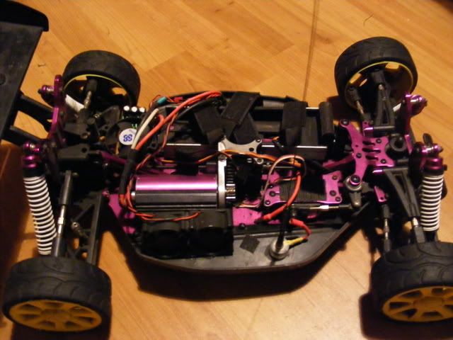

Thought I would post this up here especially since I got my custom motor mount from RCM very nice piece!
Running a MM with Fiego 8L waiting on a few parts (front wheel hubs, rear shocks and steering reinforcer) also some 3s Lipos.
Got the HB lightning 2 Pro as a Semi roller on Ebay for $20.00 shipped
going a vaca for a few weeks hoping the rest of my parts are delivered before I get back so I can finish this up.
here are a few picks

looks very nice, and welcome to the forums!
you need more voltage on that beast :D

Nice layout.. looks very clean and well thought out.. looking forward to see some Video..
Welcome to the Monster!..
P.S.
You do need more Voltage.. I run my buggy's on 4s.. (For what it's worth) and yes you can mod that MM to run on 4s..

Nice buggy, you got a real steal on it, I converted a lightning 2 pro (bought new for £195) and have had a lot of fun with it, the only times its broken or bent anything is when its been going flat out and hit something concrete, it laughs off cartwheels, car tyres and fence posts.
Knowing the Lightning 2 pro as I do, I can say that that isn't one, its either an L1P or an L2RTR there are some subtle differences that distinguish mine from yours, my L2P has a lay down steering servo, it has thicker and contoured shock towers front and rear, its chassis braces are solid 7075 rather than tie rods, its chassis, front hubs and steering link bar are all 7075 and anodised purple, shocks are different too but that may be an aftermarket modification. Whichever version it is though for that price its a great deal so I wouldn't complain in case the seller changes his mind, and there all good buggys.

I am going to disagree with the others and say 3s will do you fine, while 4s will be faster, you would then have to upgrade your motor, I run 4s with an 8XL (bigger and lower KV) and it still gets very hot with the heatsink and 2 fans on it with a 14t pinion on kyosho 46t spur and with small diameter on-road tyres, so I say stick with 3s untill you get bored with the performance and want more speed then go to 4s and a better quality motor like neu, lehner, pletenberg, mega, kontronic.

The battery in the pic was just to show mounting I do not plan on using it.
Looking to get Team losi hard case 3s 3200 MAH 20C
also have some yeah racing 2S 4000 MAH 25C on order
The heatsinks I got off rcmart.com they came with mini fans but I usually have bigger fans mounted to them.
Thanks for the info on the LS2P. When I first got it it was actually labeled as a stadium pro so I order some parts and fortunately most of them fit the model I have some needed to be re-ordered and I ordered the lightning 2 parts which seem to fit.
