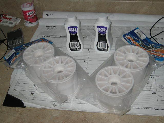

Hell yes they are.. let them soak in the "HOT" water for about 40 minutes and they will be looking good.. you will need to find something that will allow you to soak them all at once, or they might turn out different collars..
I did a dye thread somewhere months ago but here is what / how I dye my things in.. For what it worth..

Put a little vinegar on the boiling water prior to immersing the wheels. The vinegar helps in opening the "pores" in the plastic making the dye stick better.

Yes, it fairly simple, just use the liquid dye (not the powder), you will be stirring it occasionally (once every 5-10 minutes) keep it as hot as you can (IE) the cooler works best because it gave the option of covering it and the insulation kept the water (fricken hot) the entire time..
post some pics when you done.. (before and after) so we may certeak your work (as always)
