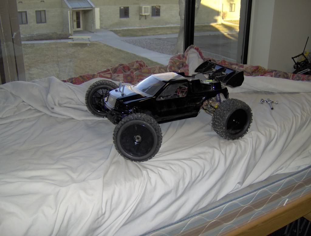

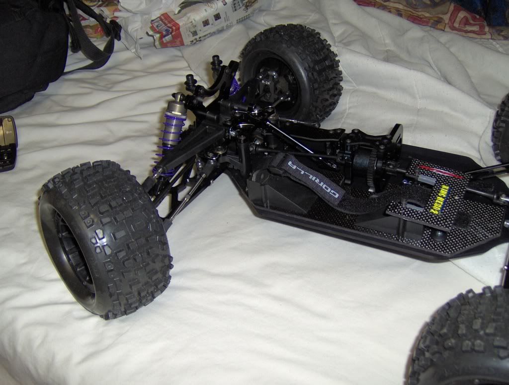

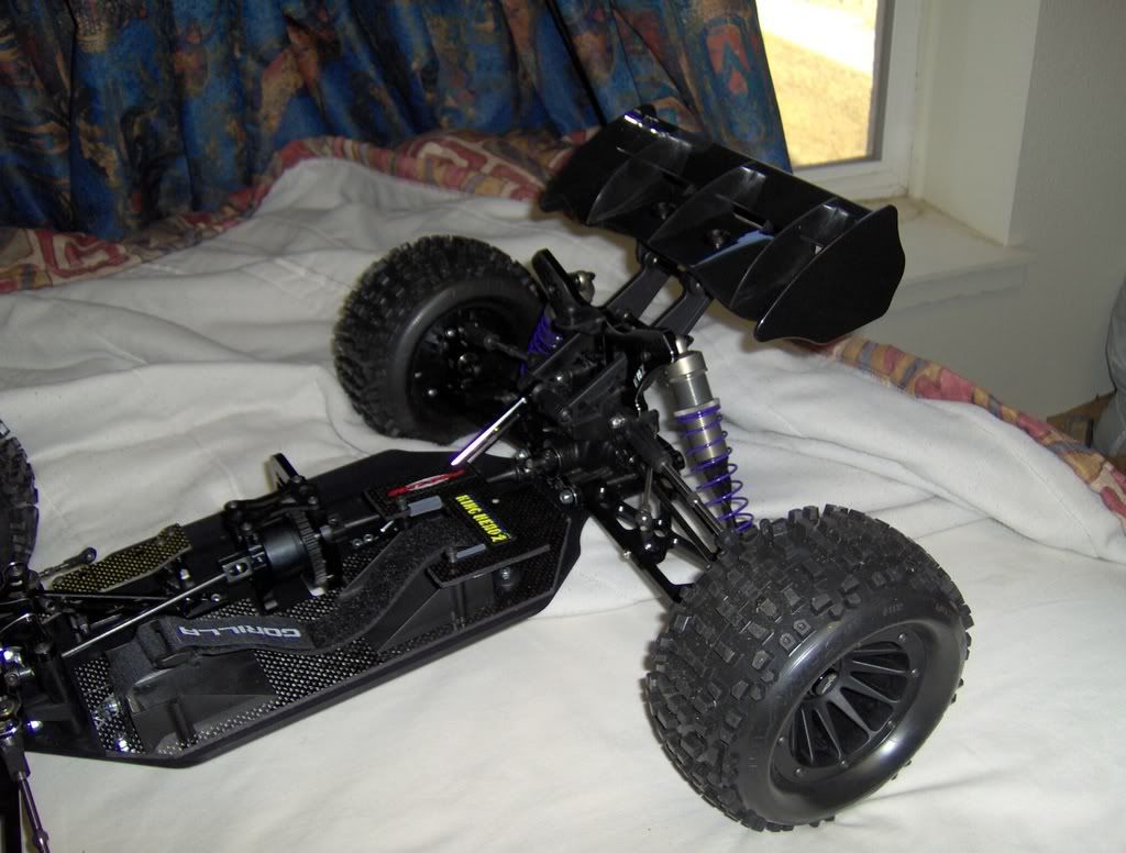

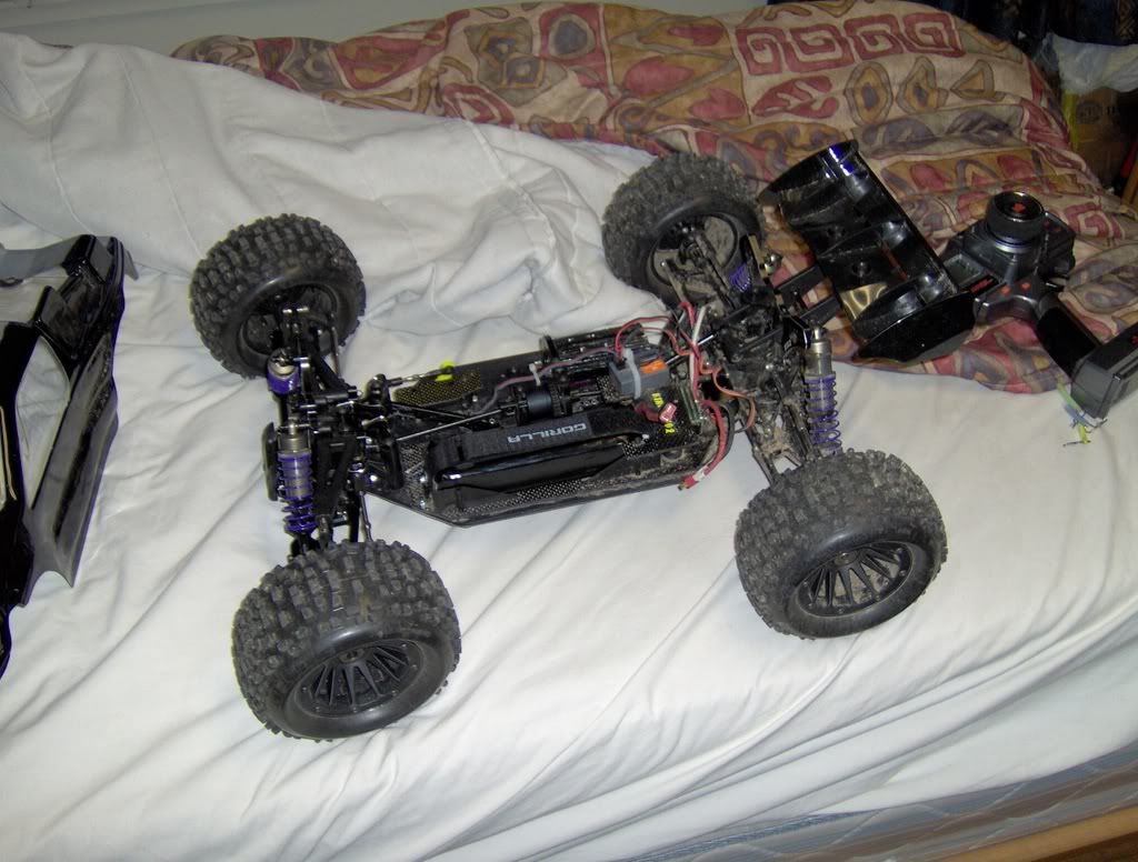

My advice? Use the stock chassis and make yourself a CF battery/radio tray. That's what I plan to do agian. Here's a CRT I had. The radio plate and battery trays were made by nl12 here on the board. I plan to have a similar design:

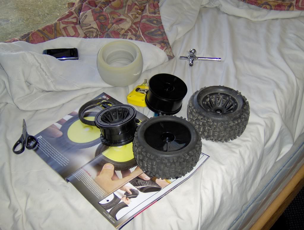

btw, what kind of truggy is that in your pics? where did you get those beadlocks? look very cool

That is a CRT. The beadlocks are maximizer x75 offset beadlocks.
