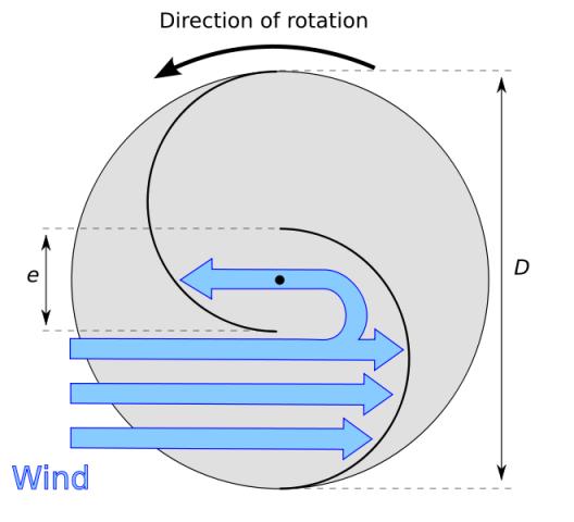

This is only about 600rpm but I don't have anything faster at the moment. I am going to start gathering parts. I think I am going to make the blades out of fiberglass for weight savings. It's called a Savonius type.
This is a pic of the type I want to make:

07.13.2009, 09:43 PM
Based on that geometry you could just get a thin tube (in the metarial of choice) and cut it down the middle for use as the vanes.
J57ltr
Posts: 610
07.13.2009, 10:14 PM
Thats what I had planned but the closest thing I have available (and light enough) is 2.5" X .0625 wall aluminum tube. I think I need something with a diameter of around 6" a Coffee can size would be perfect but it's too short. I'll look into some of that thin wall PVC. Any other suggestions?
