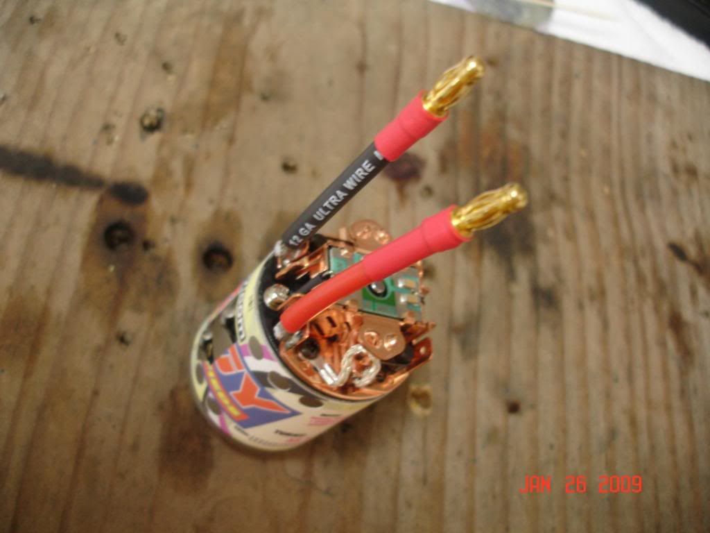

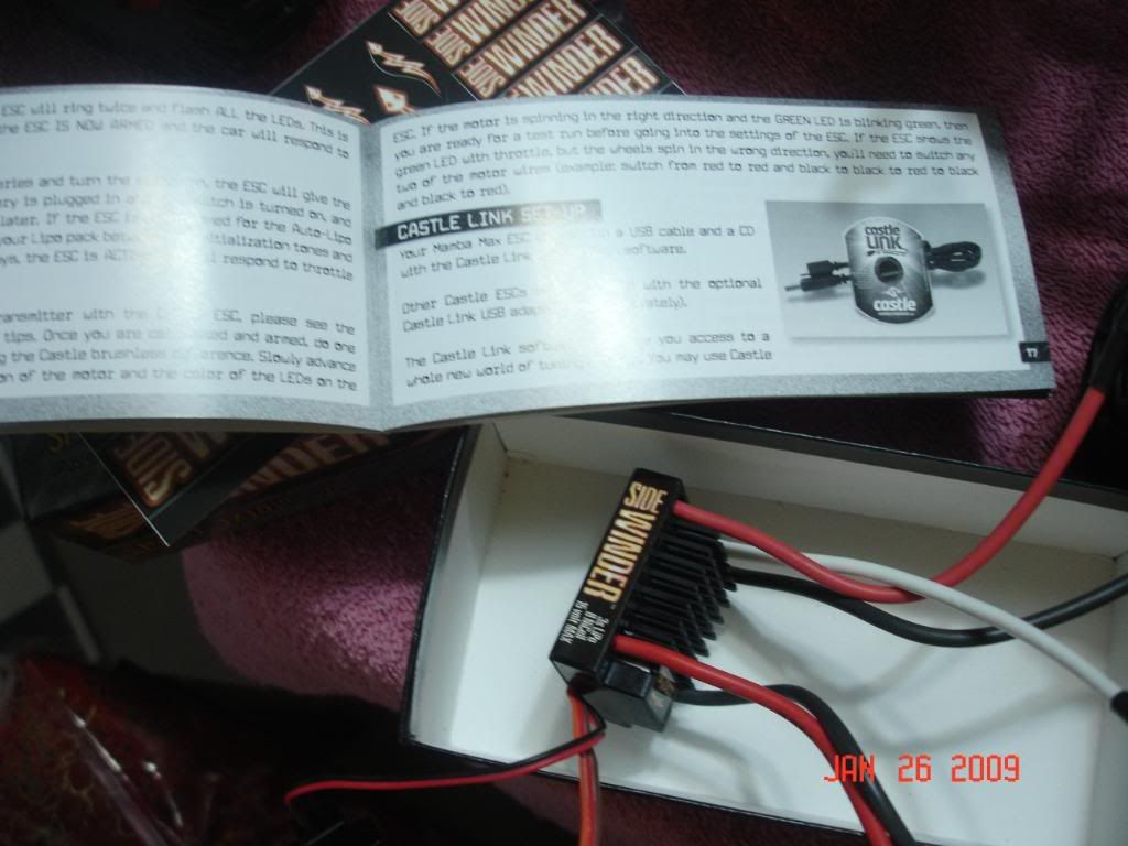

Sidewinder ESC and Integy 55T motor. I didn't realize Integy gets their motor from Japan. I could have just bought one here because it's cheaper. I'm running a 3S 2250mah lipo on this truck:

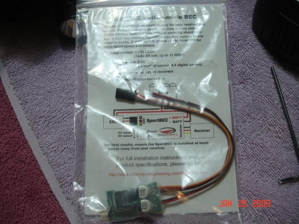

Dimension Engineering Sport BEC:

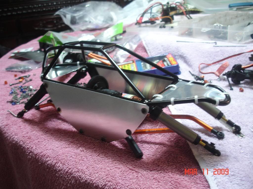

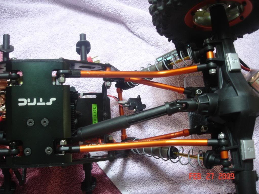

Update.

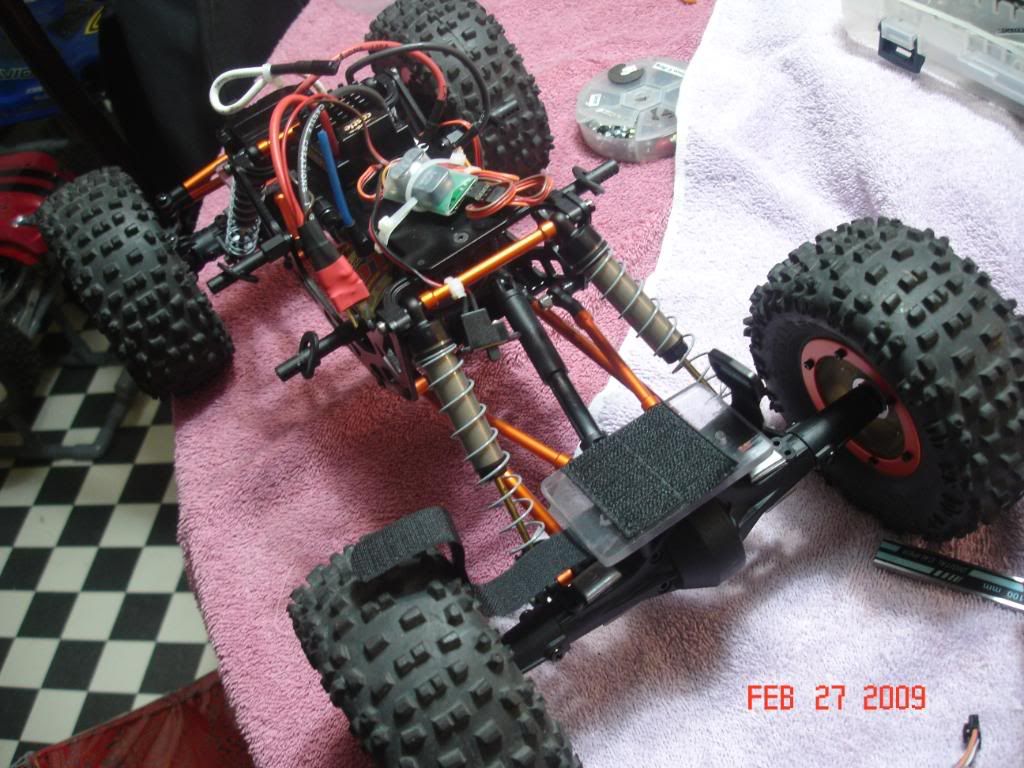

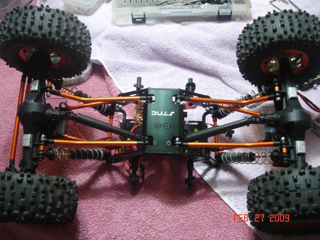

I mounted the Sidewinder ESC and 3S lipo. I made a servo and battery plate using a piece of 5mm polycarbonate plate.
I also repositioned the lower links to get more articulation. I put a 6mm orange spacer where the shock used to be and I installed the other on of the links on the inside of the transmission skid. The more centered the links, the greater the articulation.

02.27.2009, 08:44 PM
Why are you using a 3s lipo? Isn't 2s good enough? Wouldn't a 1s2p be perfect? (I don't know much about crawlers btw)

02.27.2009, 08:51 PM
It's perfect for the Sidewinder and 87/14 gearing. At least it's not too slow for my son's driving .

02.28.2009, 11:07 AM
I plan on doing the same with the links on my crawler .
metallover a lot of people use 3s so they can get wheel speed. This can be helpful at times on climbs from what i hear .

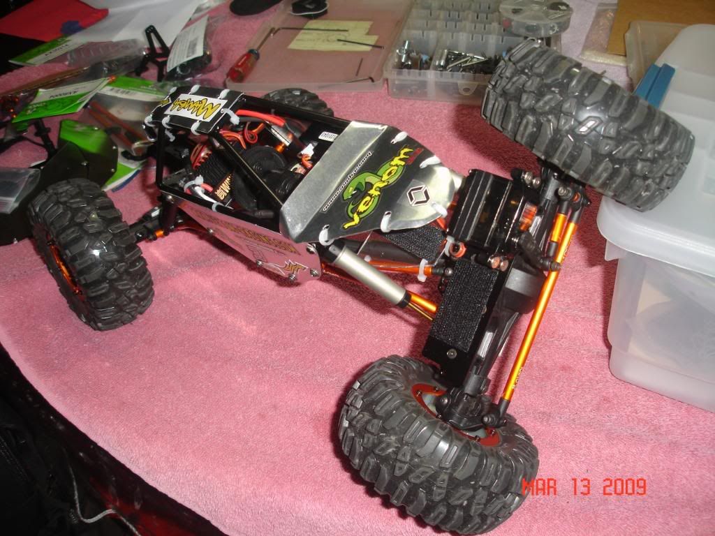

03.13.2009, 05:54 AM

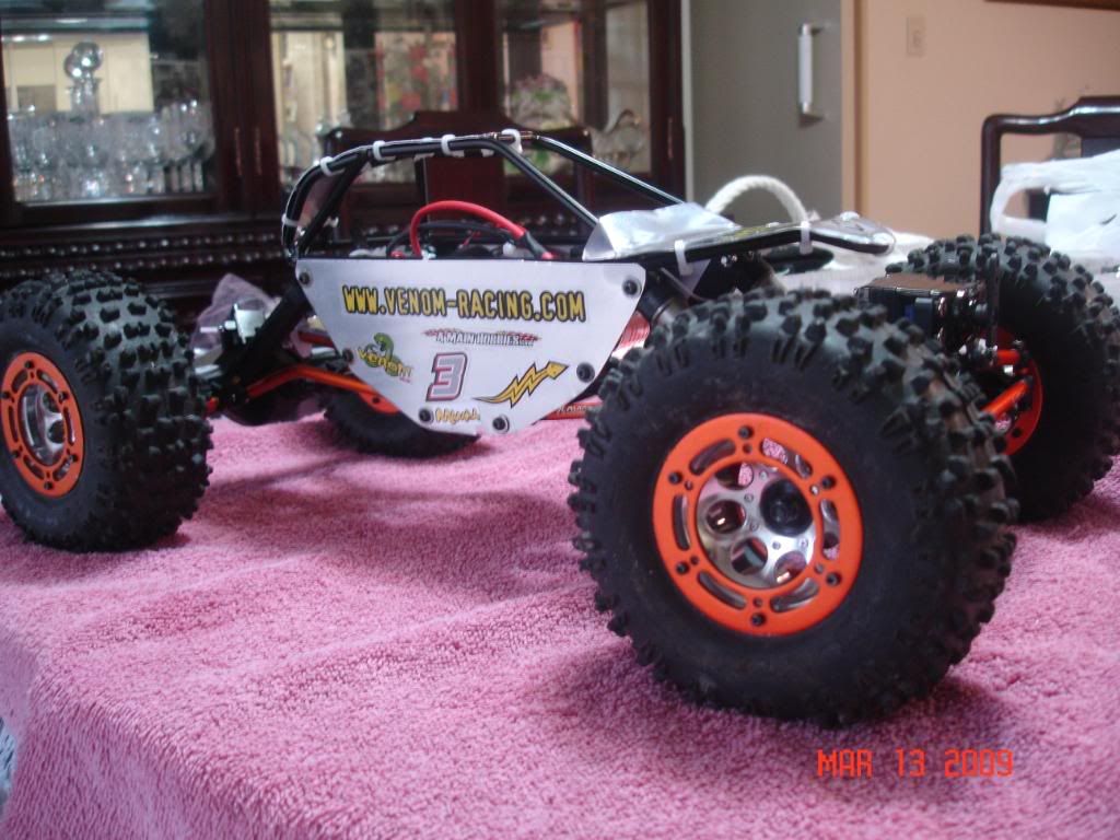

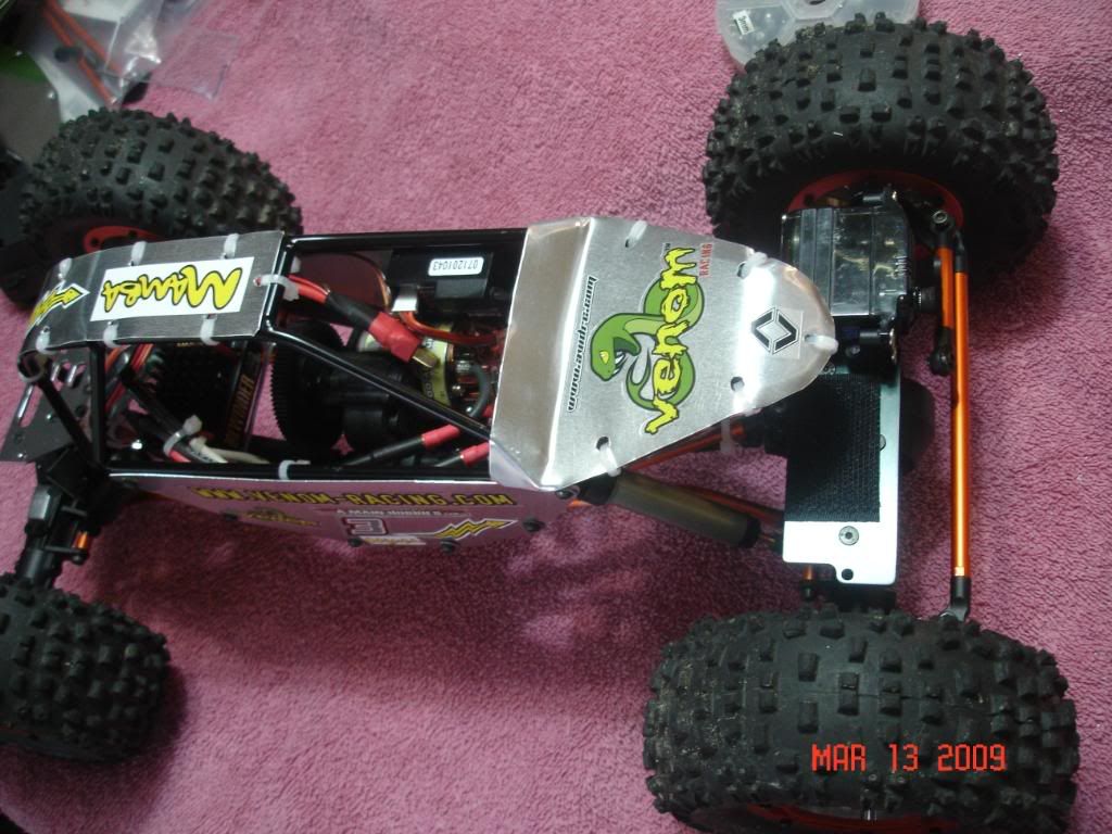

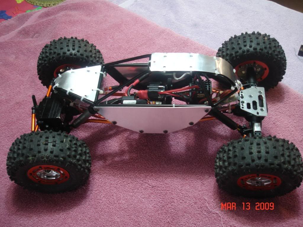

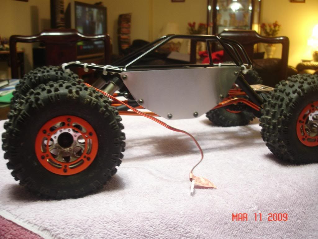

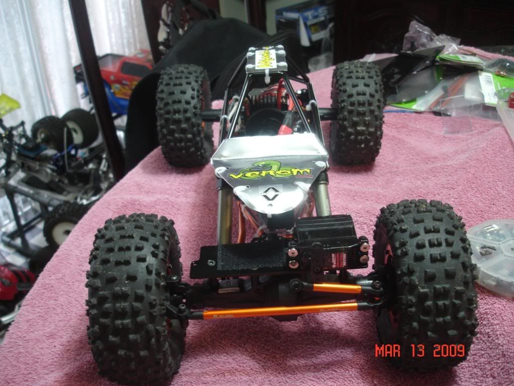

Yet another transformation of my son's crawler. I bought a TCS Edge tube chassis in order to not use a body. It'll be a lot cheaper in the long run. The tube chassis looks better too.
Anyway, here are some pictures:
Predator with OS .21TM
Supermaxx with Mach .26
Revo with OS .18TZ
Kyosho ST-RR Conversion
03.13.2009, 06:44 AM
That looks so much meaner than when it had a body! Very nice

03.13.2009, 07:36 AM
Thanks Magman.

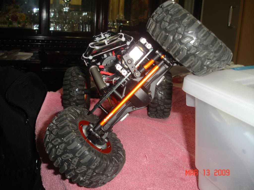

I just reinstalled the stock proline hammers since it looks better than the badlands.
Here's a couple of flex shots. I really like this full droop setup.
