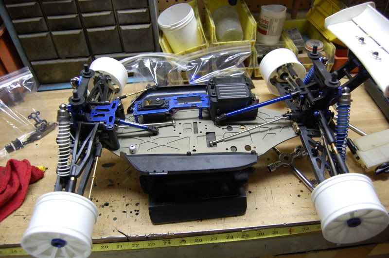

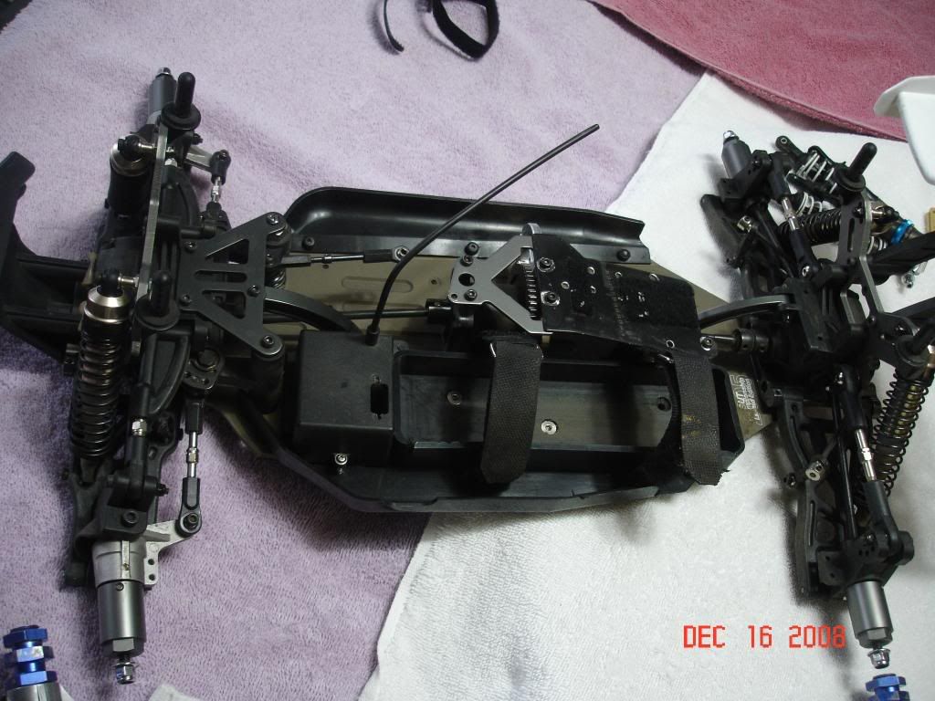

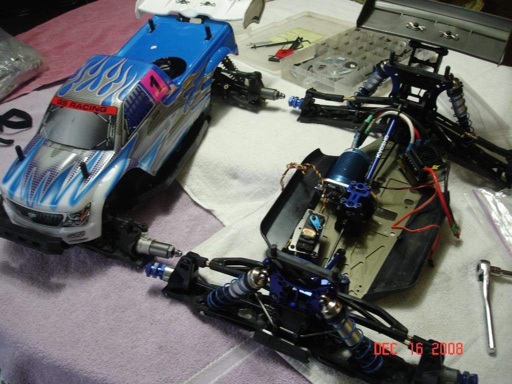

Whats up guys. Heres my ST-R converted to ST-RR (except for shocks =/ )
Anyways its a slower build considering I've got some other expensive hobbies.
Anyways so far heres the specs

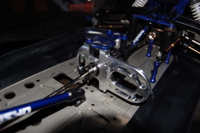

RC Monster Motor Mount
Airtronics 94358 For steering
Spektrum RX
Mamba Monster with 2200kv combo. Just ordered it today.
Couple of questions I have for you guys. It will before racing, probably should have gone for the 2650kv but oh well.
What battery to you recommend? I'll be racing at Revelation in Southern California which consists of 2 ten min qualifiers and a 15 min main.
Do I have to run a 6 cell or can I run a 4 cell? I was thinking of getting 1 5000mah 4 cell and then 8000mah for the main ( 4 or 6 cell? )
I want to keep my RX safe, I've heard of people using revo boxes. Any alternatives?

I just completed mine. I'm using a 5000mah 5S with the 1515 1Y. Any enerland based packs will be great for your setup.
I'll be using e-revo rx box (ordered mine last week).

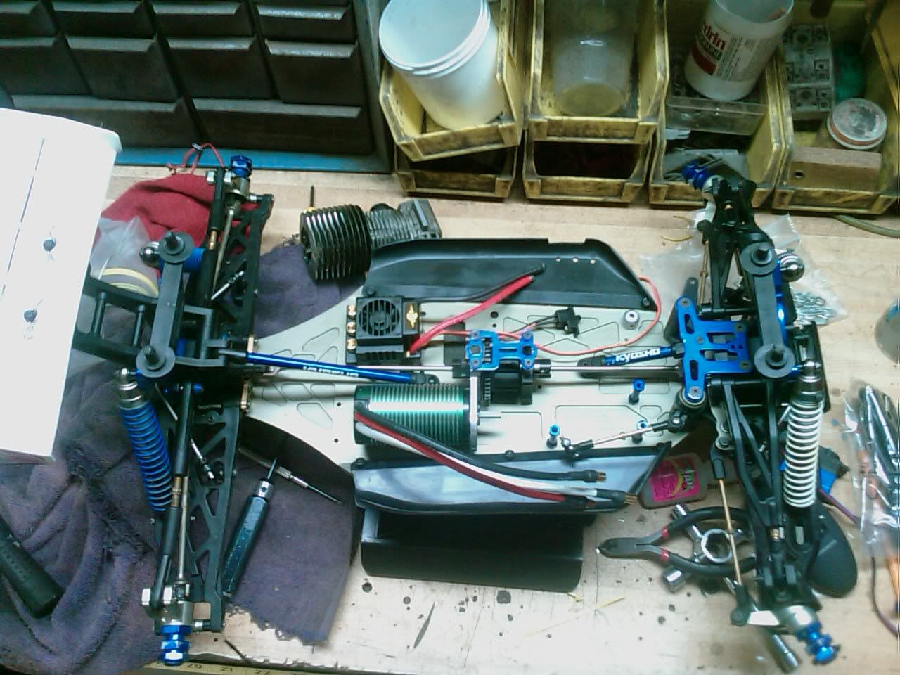

Got the Mamba in the mail today. I need to figure out a mount for the ESC.
Stupid questions but how do you know which hole to plug the wires into. There are no markings or color codes. Instructions did not say either...

I made my ESC mount using a piece of 3mm aluminum. It's screwed in 3 places and plenty strong. It also helps in keeping the weight centered.

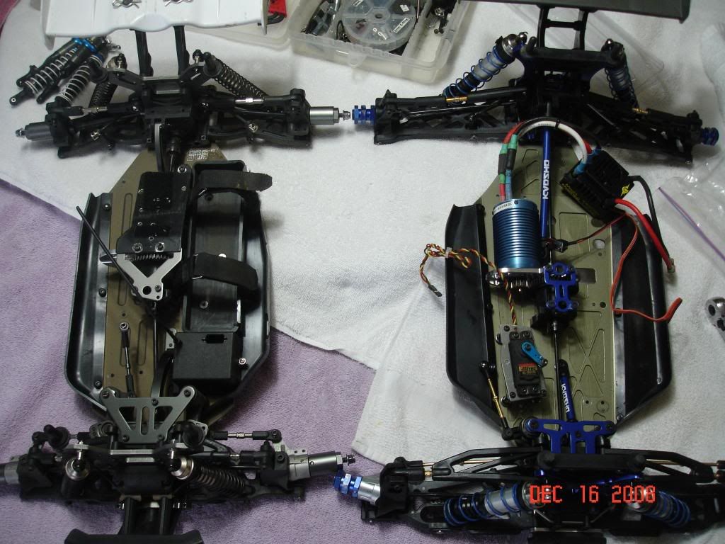

If you read the last statement on post number 3 in my thread thanking Shaun for the package he sent to me, I stated that I used the SUT ESC mount as a template. You used a different type of metal while I used a piece of 3mm aluminum for added rigidity. Thanks for the design.
http://www.rc-monster.com/forum/showthread.php?t=17312
Here's some pics of the GS SUT Shaun sent to me. It will be given to one of my sailors here. I just need to pick who is the most deserving.
Side by side with my ST-RR.
I made a smaller/narrower ESC mount for my ST-RR using the ESC mount of the SUT as a template.

12.27.2008, 10:15 AM
the motor wires do not matter , if the motor spins the wrong way , swap two of the motor leads
