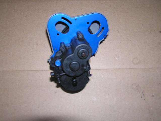

Some pictures of parts for my project. Pix of the summit chassis, front and rear assemblies are mix of summit and revo parts, and maxx tranny. The only difference I have bee able to find between the revo and summit chassis is the small notch on the ends that let the locker levers hook to the differentials.

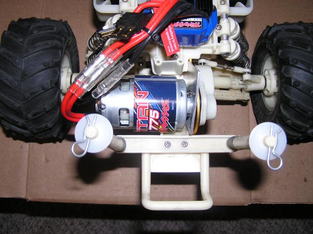

Pixs of the differentials and locking servos, all the parts I have for it assembled. Now just waiting on drive shafts, drive hubs, steering servos, shocks, and rx/tx. Have to decide on what rim/tire combo and body I want and finally the motor/s and esc that will power this monster. Last 2 pixs are of the new 775 and esc that I rigged to go in a really old truck I had laying around just to test the motor out. The torque it puts out is insane. Wants to pop a wheelie with hardly any throttle applied. Once it quits raining here and I get a basher body to help protect it I'll break the motor in a bit more.

I was going to try to run 2 of the new 775 titans. The size of it makes it hard to fit on the tranny like the 550's sit on a emaxx. Thinking of trying to make a mounting plate that flips them to face the opposite direction. At least untill I can afford a dual BL setup. I'd be happy for any input anyone has for me.

Why not just one? they seem strong enough, and les stress on the EVX. you could turn the transmission around backwards and use a erevo/summit motor mount setup

Kershaw Designs makes a mount for using dual 750 motors; you could try that out. Or call/email Mike and ask him to make one for you.
