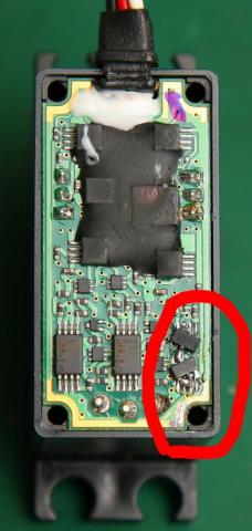

My V2 killed my servo the same time it killed itself, it was a Futaba BLS351(you know the price) .
I opened the aluminum case to found one of the FETs are burnt, it's actually a micro P+N FET module. No same component in hand so I soldered two discrete N and P channel FET instead. Now the servo works flawlessly.
