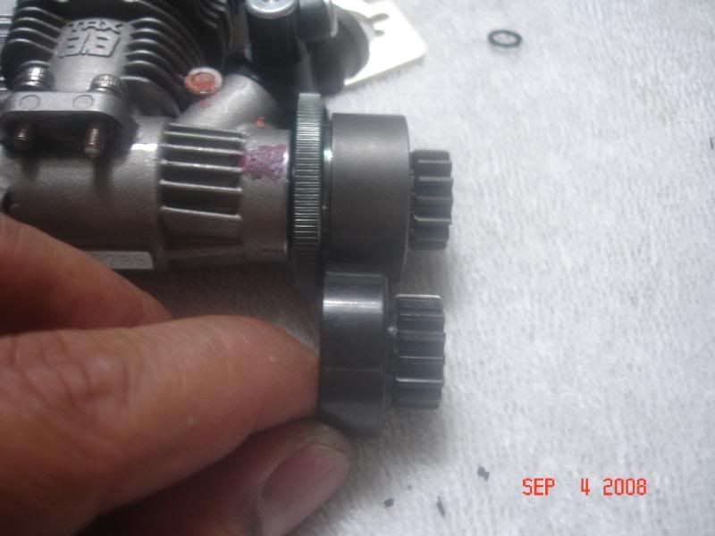

Try Kyosho narrow clutch bells. The gear teeth are closer to the bell itself compared to the muger orother clutch bells. Its what I use on my bb supermaxx and Revo with .18TZ.

To George16- With the Kyosho clutch bells, is the actual bell narrower too or is it a standard width bell?

I don't have any more of my Mugen and HPI cb to compare with but here's a comparison pic with a revo mod 1 cb.
So that would be the Kyosho bell on the engine? Looks like it might work for me, I will look into those some more.
Check "RacersEdge" clutch bells.
I have been looking at them on A-Main but I cant seem to find a side picture of one. I take it the teeth on them are cut alot closer to the bell?

brushlessboy16

Looks like its just because of the angle the picture was taken at.
Here's another pic:
