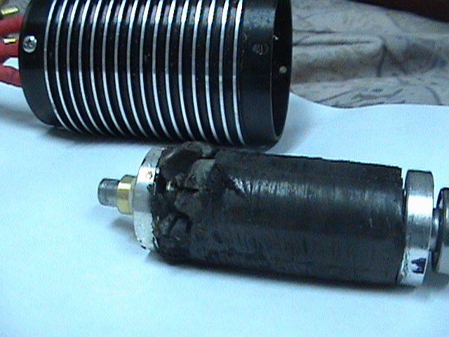

I'm somewhat a newbie to RC so bear with me. I have been having a problem with my Momba Monster setup. I currently have a v3 MMM esc and an equvlient motor to the one that comes with the e-revo BE, I am running a 5s lipo 30c 4000mAH (Eagle Power). This is installed on a Cen Matrix TR FRE, brushless converted with the rc monster motor mount. I recently destroied my second motor (pics below) the first one i was running 11/66 or 62 cant remember whatever comes stock on a the truggy. The second time I was running 11/52 motor temps were good and esc fan would never come on, also i was running with the body off, so airflow was not a problem. I mostly us the truggy for bashing and was planning to start taking it to the track but am now getting very frustrated... any help would be very much appreciated.
thanks in advance.
-Justin

Guess that motor isn't equivalent. You blew the rotor. It didn't stand up to the RPM requirements.
Try a genuine motor next time. Castle/Neu or Neu.
Trying to save a few bucks can cost a lot in the long run....

What motor is that? totally different from Castle's except the cooling fins. No kevlar wrapping, carbon instead. The magnet doesn't look like neodymium neither. Stator/windings/leads/screws also differ. Same size bearing though.

Pat can answer than one- they might be wrapped with kevlar actually, but they definately arent wrapped with carbon.. of gaffer tape, whatever that black stuff is...
As for what motor to buy; an official castleneu 2200kv one ofcourse- same size as the copy, but much more powerful and better quality. As for not knowing what to use- thats what forums are for = seek and ye shall find (an answer), or ask and ye shall receive (helpful info).

Either a MMM 2200 Kv or 2650 Kv motor will work great in your application. I usutally point people towards the 2200 has a much wider power range as is more powerful than the 2650.
Our customers have explained why there is no MMM/Neu motor "equivalent" and trying to saving a few bucks at this power level can be very expensive.
