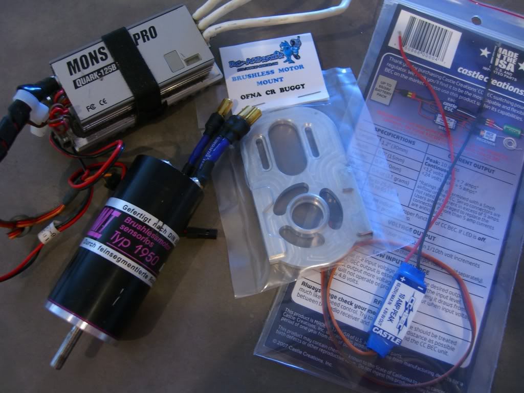

I have been doing a ton of research on this DM-1 and it shares MANY components with the Jammin Buggy and Truggy. This means 2 things to me, A) most replacement parts shoud be easy to get even though this is not a super popular model. B) The motor mount is going to be very easy as the RCM Jammin Buggy mount should be a direct bolt in since the DM-1 uses the same center diff mounts.

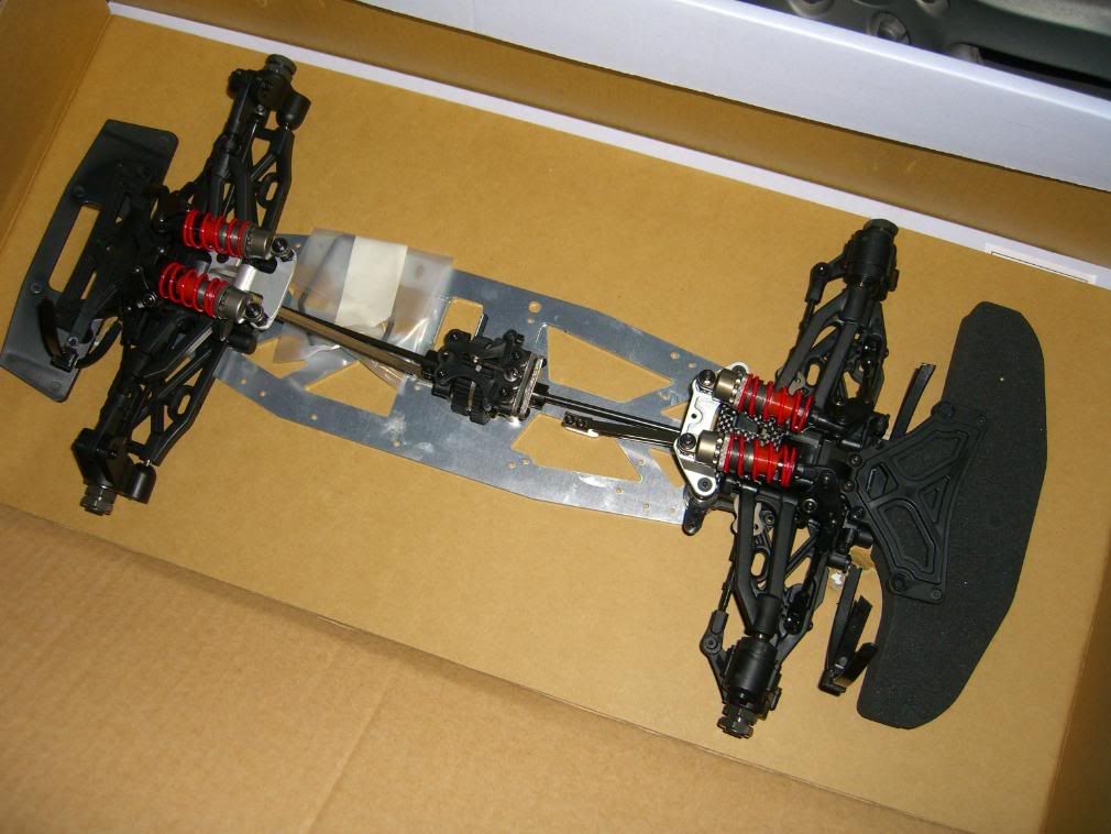

Dimensions of the chassis are the same width as a standard 1/8 buggy but with a narrow 3 inch extended chassis and no kick up
I am planning to keep the 2 speed and the mechanical brake for this one so it will hopefully lighten the load on the ESC to the point where I can run the Quark without needing any crazy mods and still not overheating it. The motor is going to be a Lehner 1950/7 and I'm planning 5s.

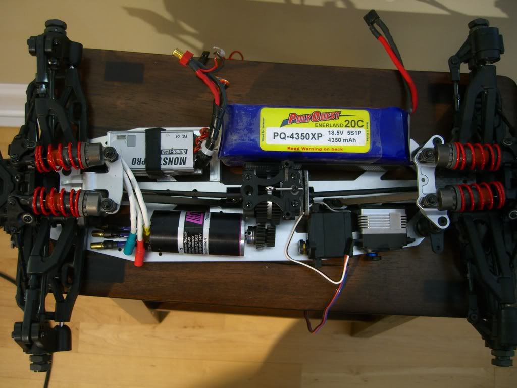

Heres a pic of what I am thinking the layout will look like. The brake servo still needs to be thought through. It might get moved in between the battery and the front center drive shaft.

nl12 - I made the 2 speed pinion. I cut off the bell on a 2 speed clutch bell and used the screew on 20T and 16T gears. This one http://www.hobbypeople.net/gallery/149797.asp Then I made an aluminum insert with the set screw and 5mm shaft hole that press fit into the place where the bearings go in in the clutch bell and JB welded it into place. I was actually using it in my XLB 2 speed setup so I had it already. I will make another one when I get a chance. I'm using this one for fitting everything up and to get it up and running until I can get around to making another one.
Mallanaga - No I'm not converting it to a buggy, just converting it to electric from nitro. I'm planning to use it for parking lot oval racing.

btw; Ditch that 2speed..
Trust me, the wheels will be screaming for grip all the way.. the serpent with the softest shore tires was having serious wheelspin when going from 70% wot to 100% wot..

I may wind up ditching it after I get it built and tested. Just a matter of droping in a standard center diff and changing the pinion. I'll see once I get it running and decide then. For now I am going to plan on using the 2 speed.
Another benfit of going with a center diff may be better cornering, but once again I can decide this once its up and running.
EDIT: And btw... I'll be runnign rubber tires on this, not foams. It takes standard 1/8 buggy wheels and buggy on road tires.
