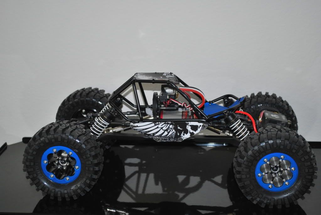

Axial axles,
Eclipse Tuber Chassis
Eclipse chassis
Delrin skid
Vanquish revolvers with weights
Losi comp claws / Switched to Flatirons for rock Racing.
Proline 2 stage foams
Jato shocks with yellow springs
Tcs rear plate & battery plates
Hitech 645mg servo
Axial steering links
Axial carriers
Titanium gears
Rc4wd punisher shafts
Westend machine links
All grey links with revo ends
8 cell 9.6 volt split pack
Tekin fxr
Tekin hotwire
Tekin 45 pro
DXR3 prodsmII
Tekin RS 17.5 Brushless
Who I bought the esc from had done something wrong and it was fried and cooked some more for me. I am sending it in and for the meeantime I figured I would try a Tekin RS with 17.5 brushless motor.
I have some light weight wheels on the way for her this is just for mock-up....but it works.

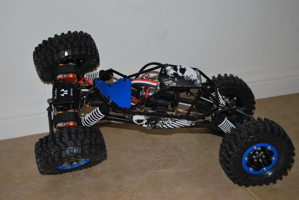

Axial axles,
4 linked fornt and rear
Delrin skid
Vanquish revolvers with weights TEMPORARY
Hitech 645mg servo
Axial alum carriers and c's
Titanium gears
bent bent delrin links
All grey anadized links with revo ends
Tekin fxr
Tekin hotwire
Tekin 45 pro [/SIZE][/FONT]
DXR3 prodsmII
As a roller

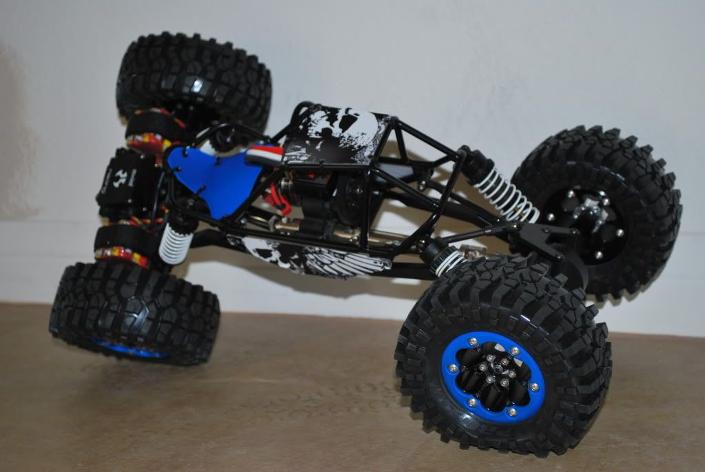

Some changes with added Tekin RS sensored 17.5 brushless. and some color.
