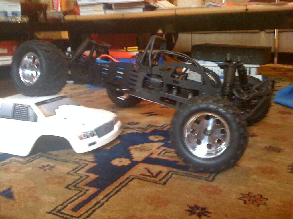

Anyway, i am an EX nitro user and have seen the light with my Brushless Savage Flux.
Just a quick pic as this is not a build up thread.
Running Stock Torq2200kv motor 20/44 gearing only on 6s.
Desertboy17 chassis XXL

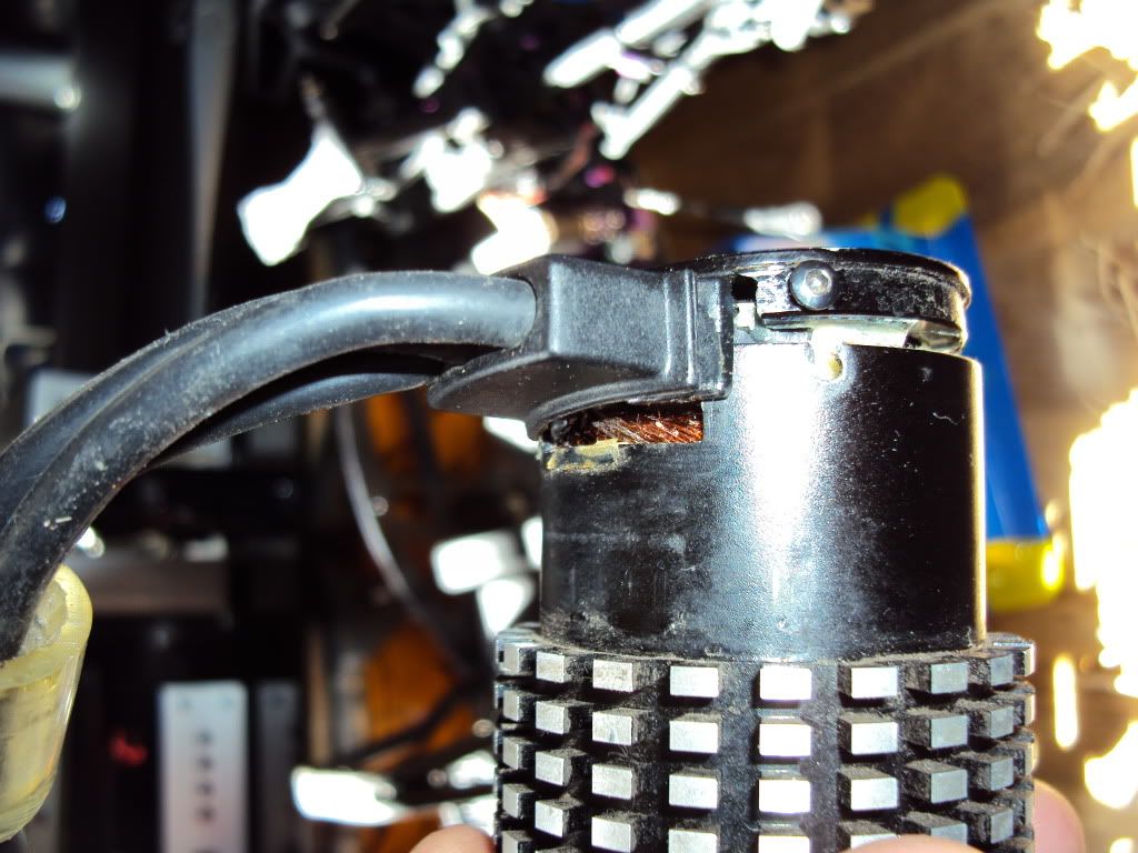

Anyway... i stupidly let my friend have a go considering i want some company when running this thing... So first thing he does is a WOT Run, and IMMEDIATELY hits the only lamp post in the car park! The damage is below:
So this is obviously why im here... Im trying to get advice from experienced users as to what motor i should be looking for. Obviously the motor i run depends on what i am looking for from the truck.
