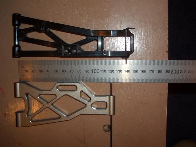

Here's a pic of an rc8t front arm along side an lst2 arm. I don't have a loose rear arm but I'm guessing it would have the same dim's.
Truggy dim's are- A= 139mm / 5.472in
B= 56mm / 2.205in
C= (If you were to cut it) maximum 25mm / 0.984in
