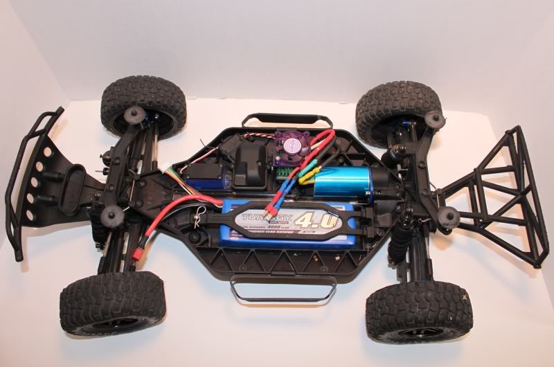

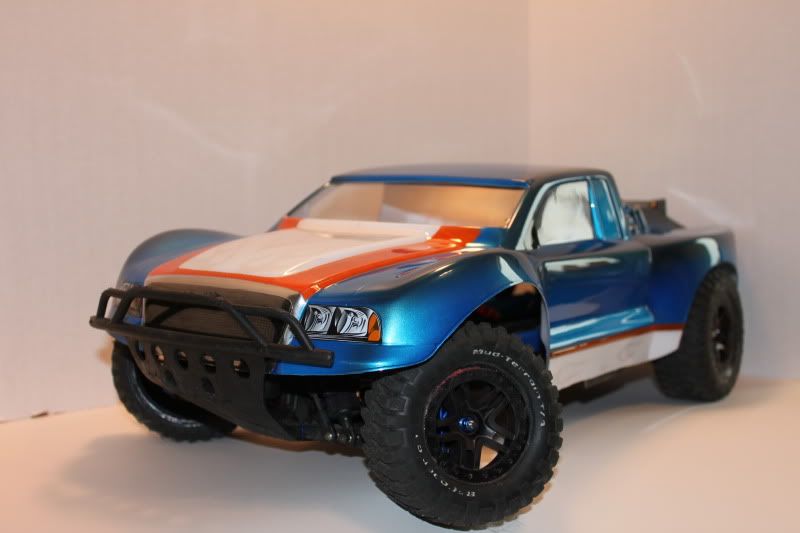

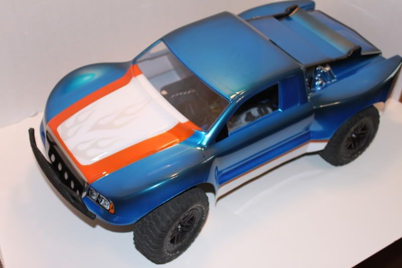

Well, I got one used last night and had to get it running. Oh man its a fast one. It is a stock Platinum Edition and the chassis has been dyed black. I also added this sick proline body my buddy painted up for me. It is so badass, thanks again Josh.
So, I knew I wanted more power than the stock VXL setup. So, I took a Mamba Max with extenal bec, added a Novak Fan from an HV-Maxx esc (it bolted straight to the chassis!), and a feiago 10l motor (2600kv), just the random electronics I had laying around. I am running it off 4s 20c 4000mah packs, but I may end up stepping down to 3s. Right now the ESC and lipo stays at 90* after serious bashing, but the motor got up to 180*
So I think I will run 3s until I get a higher quality, lower kv motor to replace it. Needless to say though, it is crazy fast.

what gearing are you running?
N. Rustler conversion
4xFord
05.12.2010, 03:06 PM
Damn I knew I left something out. Its 14/54.

Nice Slashy. The ghost flames and shadowing looks really cool.
I have 2 myself and have ben having a LOT of fun w/them.

Well that super high quality feiago let the endbell loose in its second pack through it. So its definately time to upgrade. I would love to find a nice medusa to replace it. Novak HV motor prices have gone way up since these 4x4 SC's are so fond of them.
