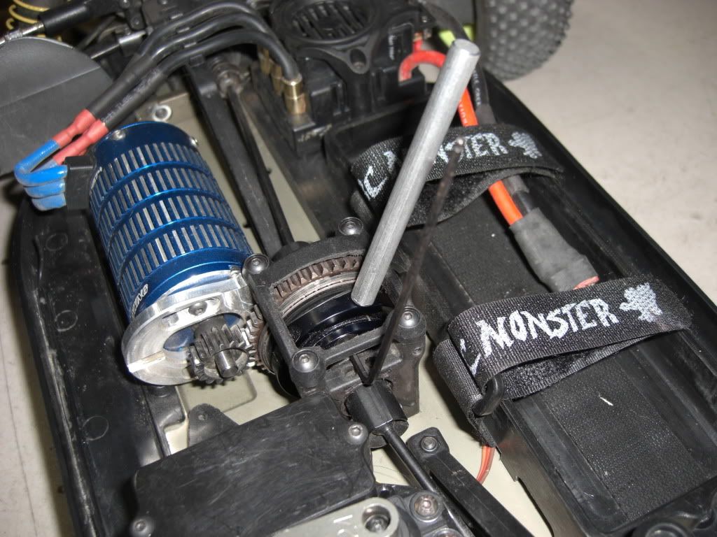

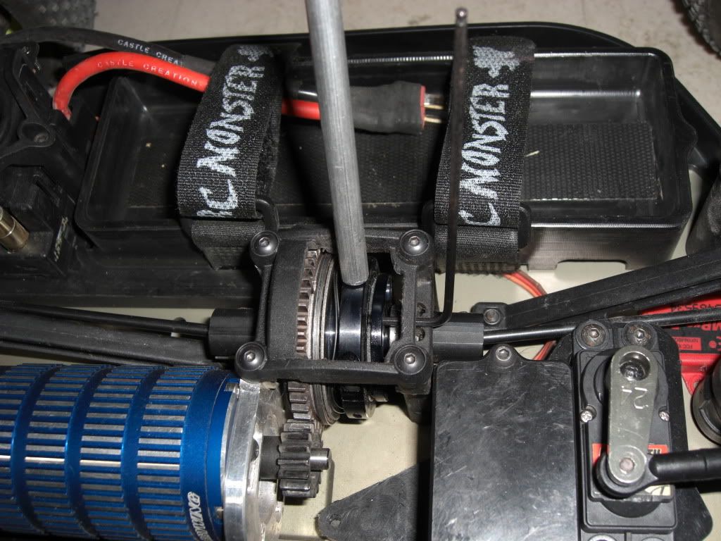

After installing the slipperential it does require adjustments during and after break in and I found this to be a little bit of a pain trying to hold the buggy down, turn the adjusting ring...you know! Then Mr Obvious jumped up and smacked me with the solution, simply insert an Allen wrench in one of the screws in the small end cap to stop the diff cup from turning while turning the adjustment ring
Like this.
