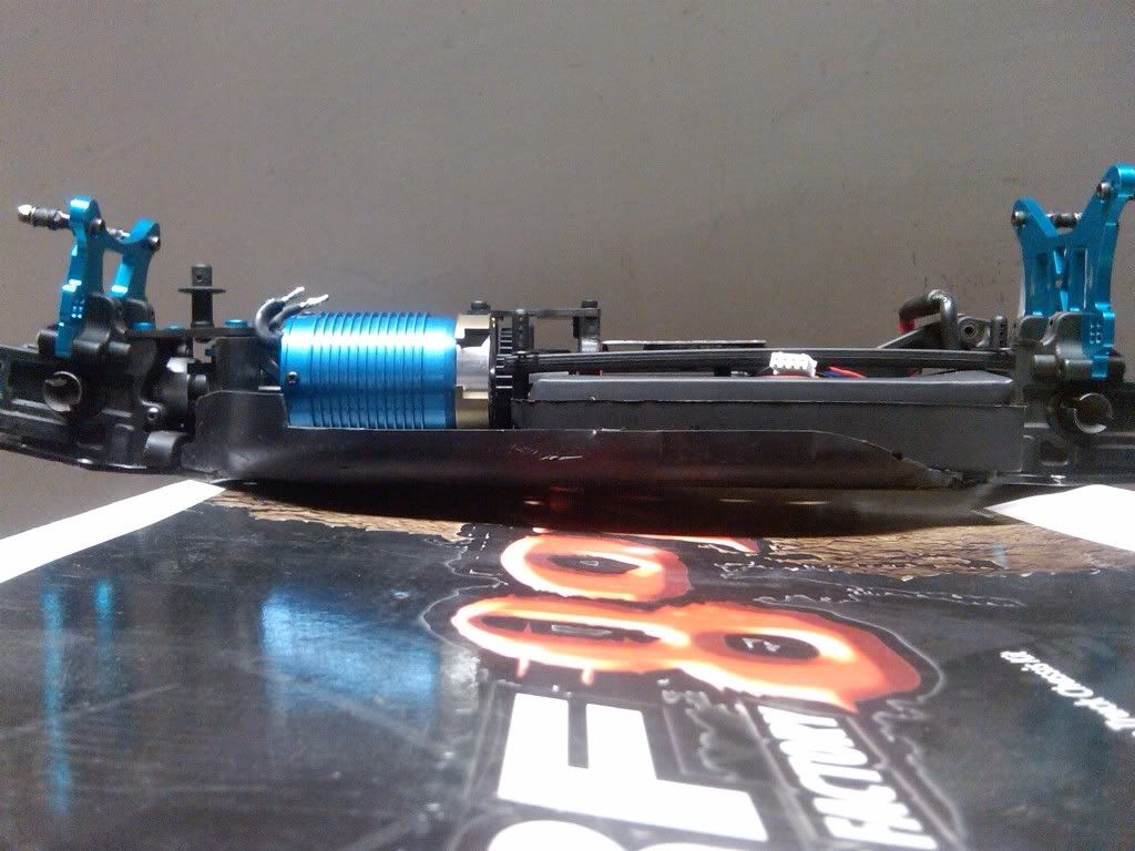

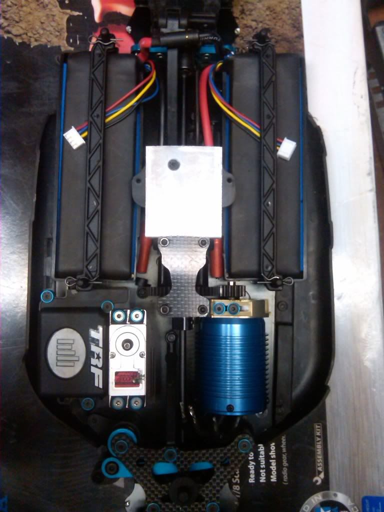

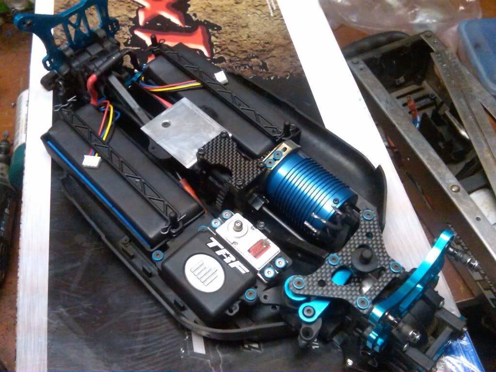

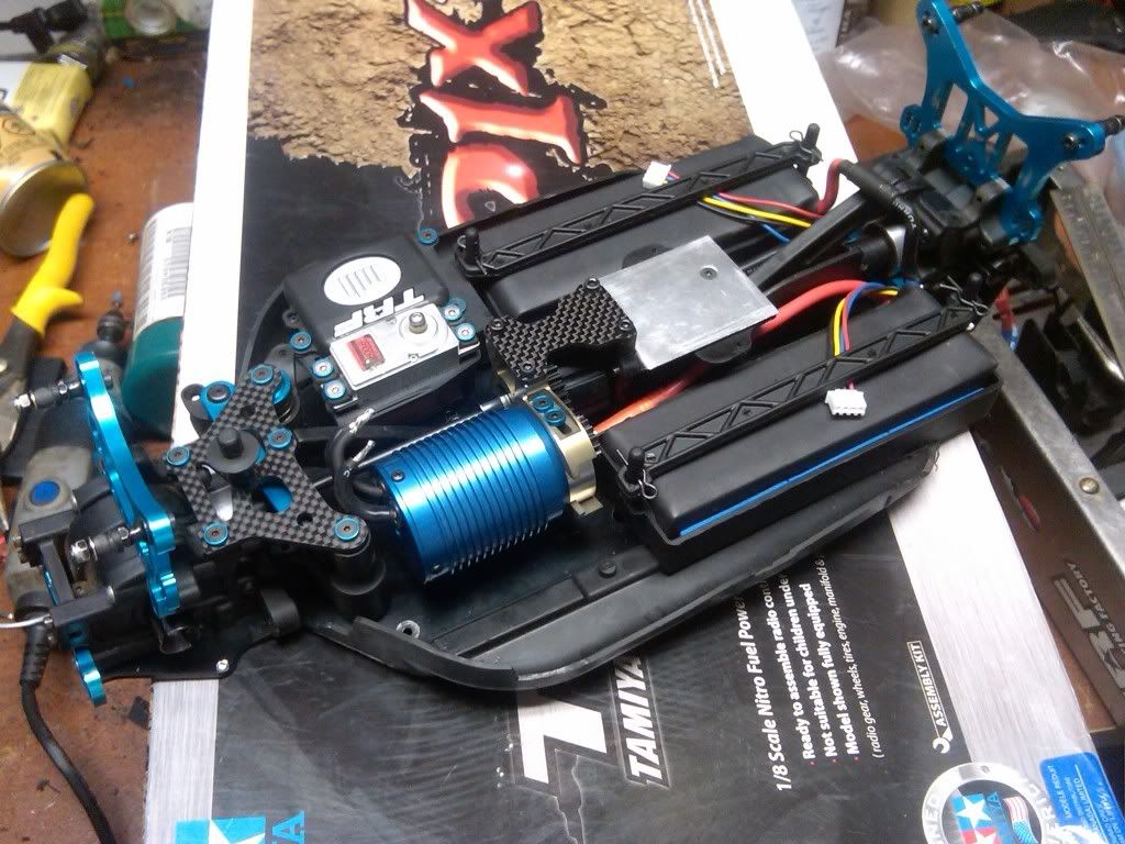

i snaped a couple of pics of my conversion... the battery trays are from a caster fusion, the servo mount and radio box are from a losi 8, the motor mount is from Elite RC (Mugen mbx6)... the motor is a neu 1509 (1450kv) and the batteries are two 3s 3000mah in series to make 6s total... all run by a castle MMM... i also have a MMpro i might try...
as you can see its a tight fit but weight distribution is 50/50 F/R and L/R... you can go up to a 1512 size neu motor but not the 1515... you can use the same mount to do a traditional conversion with the battery on one side and the motor on the other as well...
i'm using a losi plastic spur (43t) which fits right onto the stock diff with a 13 pinion... this gearing should get to 35-40 mph with max motor rpm of 30-35k...
i haven't run it yet but i'm hoping it can make at least 15+ min...

I like it. Let us know the official running weight of the buggy once it's done. I'm curious if the 1509 will be enough to run it without heat problems.

I ran my 1509 in my mbx-5 on 4s w/no probs. It was a little warmer than the 1512 but, w/Neu quality, I wasn't going to worry

looks great, the 1509 should be fine as long as the buggy is lite or geared low

I love the Elite RC motor mount. Awesome design for easy motor and pinion changes.

What is the finished weight on that? I think you will find the 1509/2.5Y on 6s to be a great set up for racing. I think it will do 15 min no problem with 3000mah batts geared for race speeds. I have same motor on 6s 2600 in my Ve8 and only put back 1400 to 1600 mah after 10 min. main + couple min. before/after race (small/tight track).
