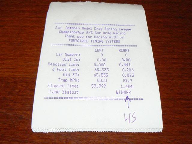

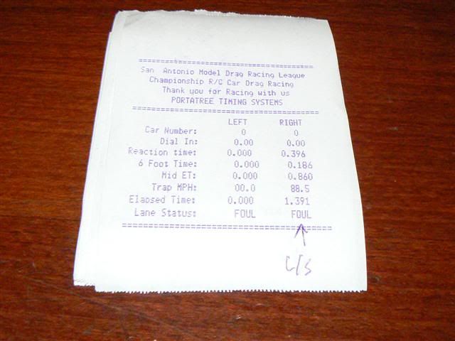

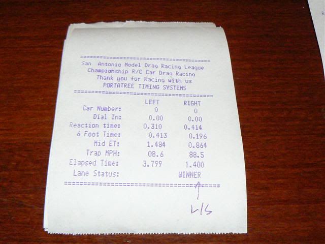

Changed over to MMMs from my trusted MMs in my 3S Top Fuel Dragster and 3S Top Fuel Funny Car. I had no idea that there would be a noticeable difference. I am partly correct, except that there is a slight improvement which was noticeable for me.
Here's the numbers from my Dragster:
These were consecutive passes in an open track session after racing today and I was impressed that the changes I made in the ESCs were directly translated to improvements in the numbers. The MM was not that clear cut for me.

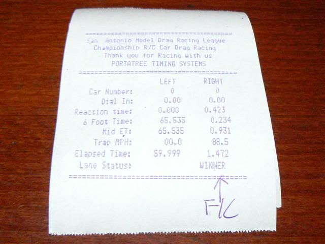

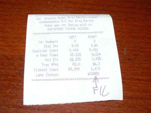

Here's from my Funny Car:
Couldn't do much here since I ran out of tires to test with.

Good to see a 1.3 there Sunny. The MMM does flow more current than the MM, especially at burst. This is where you see the difference. Are you going to take out the heatsink as some other people do? Every little bit of weight loss makes a difference.

I would guess that the times are quicker with the MMM for two main reasons:
1. The MMM has a little lower resistance than the MM, so currents to the motor will be higher (and thus, more torque).
2. The MMM has a more sophisticated back-EMF circuit and a faster processor, and can lock timing earlier than the MM. (and thus, higher torque earlier...)
