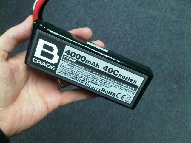

Saw this on the HobbyKing blog while browsing around:
"New B-Grade LiPo.
Same quality and reliability as eBay packs.
Price: Dirt Cheap
Cycle Life: 50+ only
Good for low discharge testing and not-so-critical flights."
They say good for low-discharge testing, and then slap a big 40C rating on it. You know there will be plenty of people who won't even read the description. Same quality and reliability as Ebay packs is NOT a selling point IMO! I'm already starting to smell scorched electronics and venting Lithium gasses.

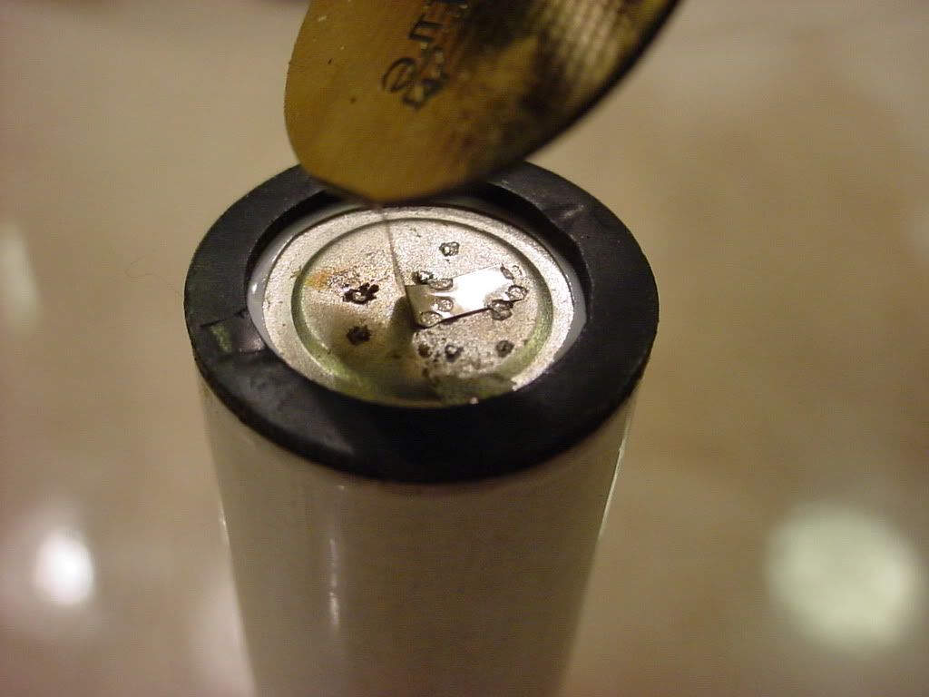

I recently purchased 3 protected 3000mah 18650 cells for a flashlight that I bought.
The flashlight would only shine for a minute or two before the cells hit their built in low voltage cutoff.
Discharge testing at 1 amp only showed 150 - 200mah of capacity.

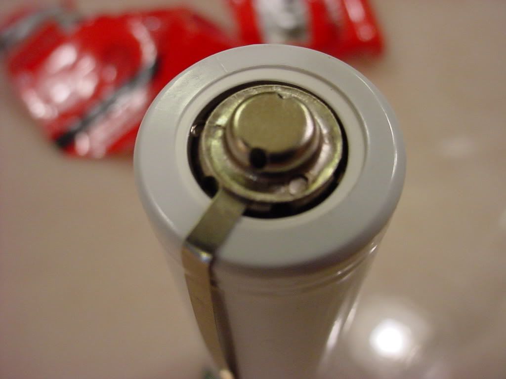

Protected cells that were counterfeit. My guess is "fresh" out of the recycle bin.
Alot can be hidden under shrink and end caps.
Check this out.
Looks good so far.
Photobucket
Under the cap, notice the multiple weld marks and the scrapes to remove them, before the new cap was added.

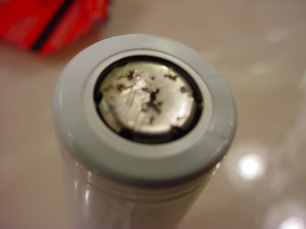

Yes, on the other end too. There's even some rust.

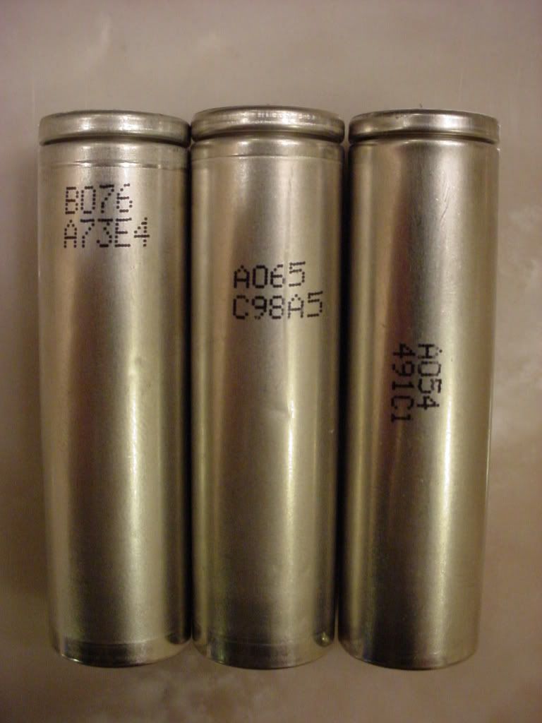

Notice the dents on the naked cells. It's like they were all dumped together in some large bin. This doesn't happen on the production line.
Also note, different lot dates on the 3 cells. Definately not the same run. Probably not even the same brand.
